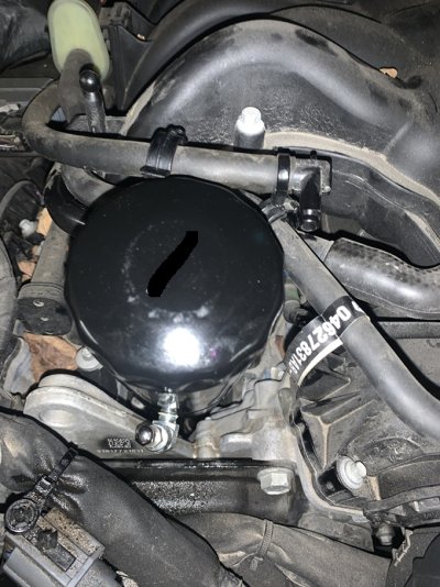

Vac-Extract most oil out of the dipstick tube, the rest out of the drain plug, and a Baxter spin on oil filter adapter take all the mess away when doing a 3.6L.
