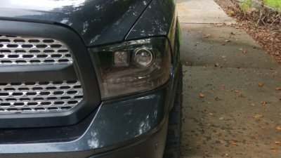

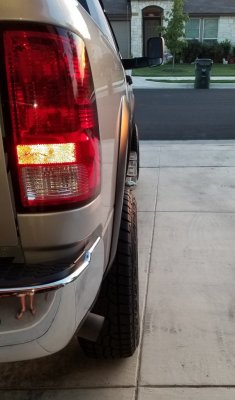

I'm sure others will come in with a more exact set up but here's a pic of mine, 2018 2500 with 20x9's 275/65, zero offset20180930_191058.jpg

How much did they stick out pre flare? That’s a look I’d be willing to go for right there [emoji106]
Flares are oem so not sure
