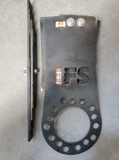

Best thing to do to check wheel fitment is get a wheel sizing tool like this one, then you can set wheel diameter and width and check fitment. 4ad8ed7ee9a509876dc3ab0c39f8dfdf.jpg
