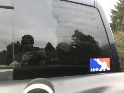

I spend all last weekend claying my windows, then trying vinegar and finally metal polish. The clay worked great on all windows but the back window. For the life of me I can’t get the spots out. Should I soak a rag in vinegar and let it sit on the glass? Would a scotch bright pad do the same as steel wool? Sorry for the Questions on questions but it’s been driving me nuts. I have 5% tint over the factory 20% so the water stains are very noticeable

https://www.autogeek.net/duragloss-nu-glass.html I have used this stuff for years. I have not found anything easier to polish waterspots off of windows with. It is a little chalky on the residue side and does take a little elbow greese. Once you are done it will shed water like rainx. For upkeep I just use the the glass cleaner + rainx spray by rainx. I've even used this stuff to polish scuffs out of a sapphire crystal wrist watch glass.

I agree use a machine polisher on them like you would your paint.

RainX does a great job. Also you can use chrome polish!

I hope this finds you well and in time but I swear by this product: PRO CLEAN PROFESSIONAL GLASS RESTORER by Glasweld.
I do detailing for a side gig here in Hawaii so I deal with a lot of salt water build up on mirrors/windshields aside from the body. I've tried many compounds/pads/polisher combinations and this BY FAR is the fastest and most effective.
The application process:
Put about a half dollar size amount of the product on fine steel wool (0000). Scrub the window until it starts to haze over. Once dry/hazed I like to spray some Stone Glass Cleaner to remove the product. Finally, I top it off with glass sealant for a layer of protection.
