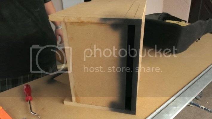

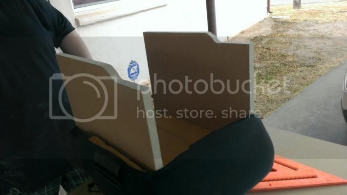

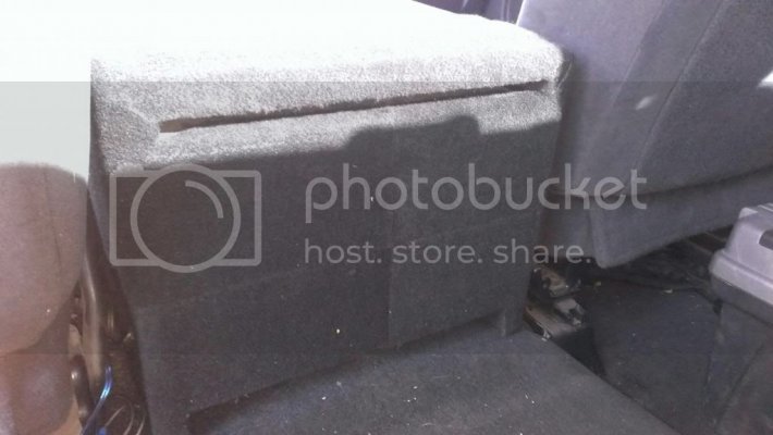

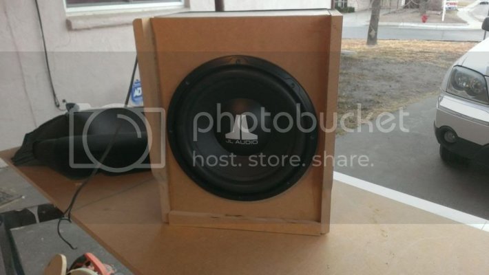

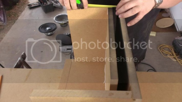

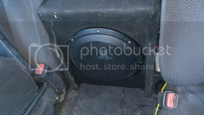

ok so i used 3/4 MDF and have a 1" port with a jl audio wx-4 Rms only 200W but it pounds!!

Downfire enclosures should have the cone 1/4 the sub diameter off the floor. If you raise it, it'll get better.
