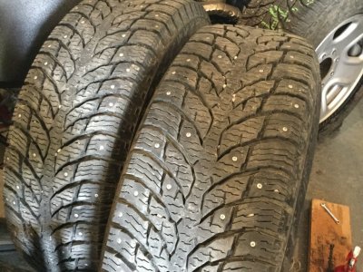

It’s not uncommon for people to run studded Ipikes on their snowmobile trailers around here. They’re cheap and seem to meet the weight rating.
For the truck, studded hakka’s do the trick... probably overkill for California, though
