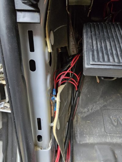

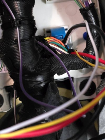

I am hoping someone would have the wiring diagrams for what is under the driver's side dash. Specifically the harness by the kick panel. It is for a Canadian 2018 Ram 1500 Outdoorsman Crew Cab. I purchased this truck a few weeks ago and am removing all the shotty wiring done by the previous owner. That was until I crawled under the dash and was met with this mess.
There are a bunch of wires coming out of the floor and some go up to this blue plug. That white box it is plugged into is attached to the firewall and looks factory. There is also a wire going from the harness on the floor. It is electrical taped to the orange wire which I am assuming is for illumination. I don't want to start cutting things before I find out what everything is attached to. The truck has the factory alarm and remote start. And there is nothing aftermarket in the rear passenger area. Or at least there isn't now. I can provide more pictures and am comfortable taking stuff apart. I just don't know the fancy names for things...

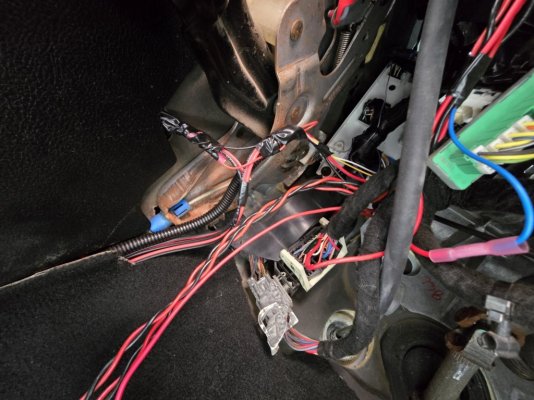

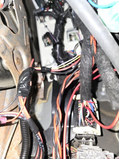

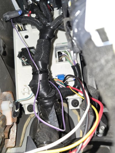

This is the best I can do. I tried contorting myself to get under the dash it was no bueno. The more I remove trim the worse it gets!
The first two are looking straight at the harness on the floor next to the dead pedal. The third one is looking up into the dash towards the A pillar and firewall. The last picture is removing the kick panel and realizing it only gets worse. The red and black wires either go under the carpet to the passenger's side or follows the channel to the rear of the truck. I will need a couple nice days to rip all the trim out and carpet to better follow those wires.

OK, on the white BCM (the blue connector) I think is this...
If you find which pins it's tapping you might have a better idea of what they are used for. I see some wiring in their that almost looks like someone added OEM remote start after the fact on the body control C7/A plug of the BCM (the purple wire hanging down in your pictures). Do you have remote start on your FOB?
I also see a cut wire to an inline fuse holder that might be running to the same C7/A connection but unsure.
Does any of this help? I'd pop the door jamb trim off and see where those wires run . I'm hoping they are using them to signal something to power on as opposed to sharing power. If you can identify the color of the wires the are tapped into with a two color code you can more easily see what they may have done.

Ok, that means they either used the factory add-on kit or made it themselves. If that purple wire is going to pin 11 on the BCM C1 connector that is what you see coming from the switch to the firewall. I'd just tuck it away a little more nicely and call that one solved.

The purple wire is going to pin 11. As for the plug at the bottom, that was powering the two running board lights. They tapped into C7/G pin 11 for ground and pin 14 for power. And also ran a fused ground to the ground tap in the kick panel. The harness on the floor that had one wire coming out was tapped into the something that triggered when the lights came on. Everything was wrapped around a bare section of the plug wires. A little tug and they just came off. And no the running board lights were not connected to a relay. They were both powered from pin 14. I will be doing the rear seat mod soon and when I pull that seat out I will deal with the wire mess in the back. Oh and that ground tap, the bolt was finger tight. What a **** show...
I will also redo the wiring for the running board lights. Is there a safe place I can tap into for the courtesy lights? I plan on just using that as a signal wire to trigger a relay. Should I just reuse pin 14? And thanks for you help. You sent me down the right path and I didn't electrocute myself or start my truck on fire.
