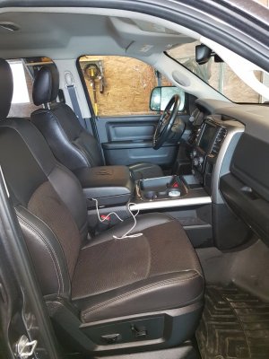

where is the best place to bring power to my seat for my Ram 1500 2017 with Electric Seat 2016.
I connected the red wire to the connector below the seat and I already tested the power.

My Truck is a SLT 2017 with more add-on !
Get a hold of forum member @DeereGuy. He can get you the harness you need to run power to both seats. He just made me one and his product and instructions are top notch (and affordable).
Quick question, did you say you put a Crew Cab seat in a quad?

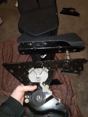

Interesting! So you just removed the bracket from your old seat and put it on the crew cab seat? Did it just Bolt right up? Is that picture with your front passenger seat all the way back?

Yes exactly !! No modification. More comfortable ! 2 inch total loss.

Can you post a picture of the yellow connector under your drivers seat closest to the front of the seat?

Yes very simple to install ! I take theparts of plastic and a drill in my bracket of the quadcab for a Good finish.

So this is temporary wire?
