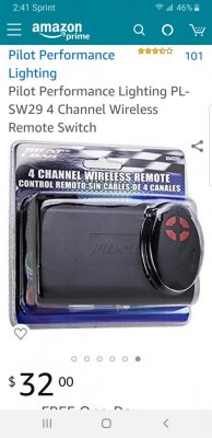

Not exactly what you are asking but a another option instead of cutting a hole in the interior is to add a RF relay under the hood feeding a secondary power relay (standard Bosch light relay) and use the overhead console Homelink buttons to turn the LED bar on and off.
You can tap power under the hood and no cabin wiring is needed unless you want an indicator light to show they are on in which case you would have to run a single wire to the cab to an indicator light - then to ground.
Some of the RF relays you can buy also have remote controls that come with them so you can operate things while outside the truck like your LED bar or a set of work lights.

This is what Scotts was talking about
