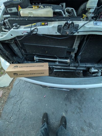

Here is my new train horn set up. Super loud. I just ran one fused relay from each horn to the battery hot.
You do realize this thread is 14 years old,you had to really go digging to find it :Big Laugh:
