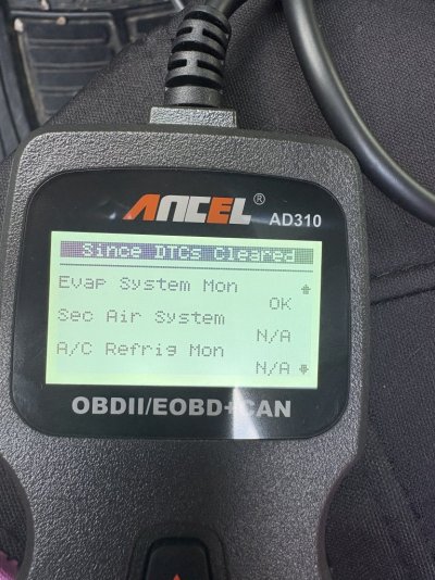

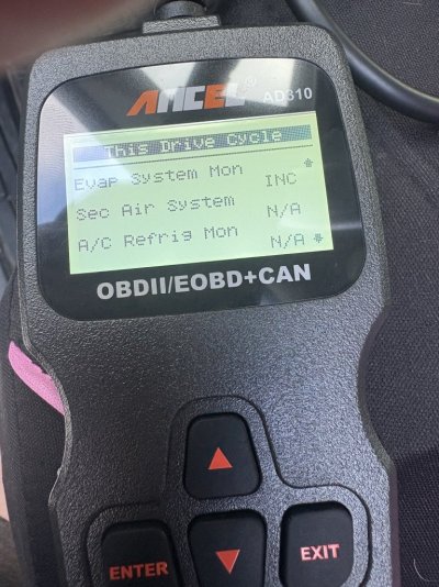

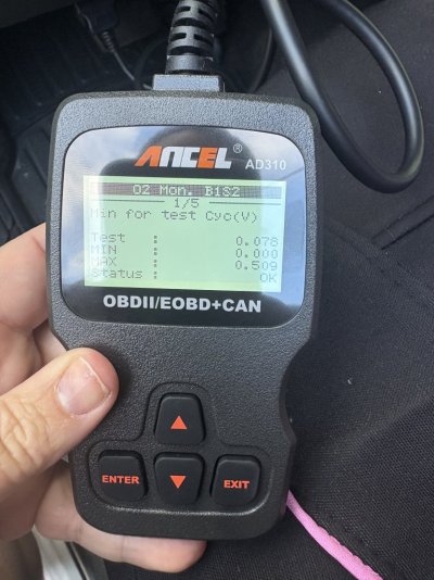

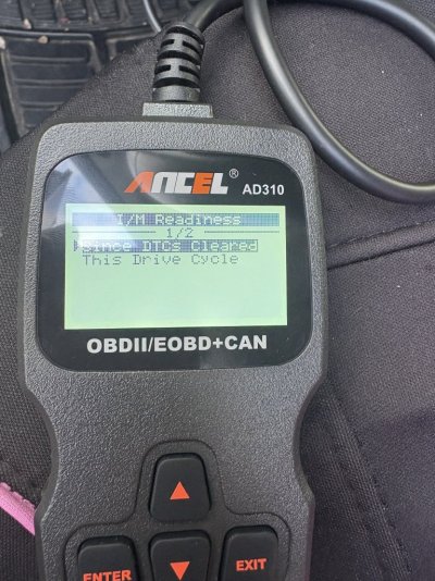

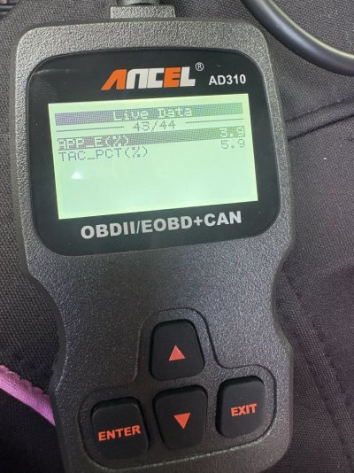

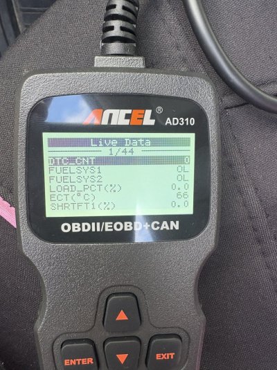

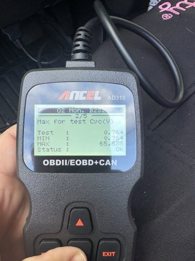

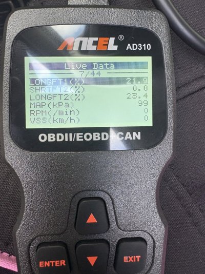

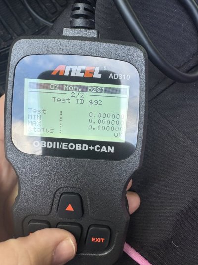

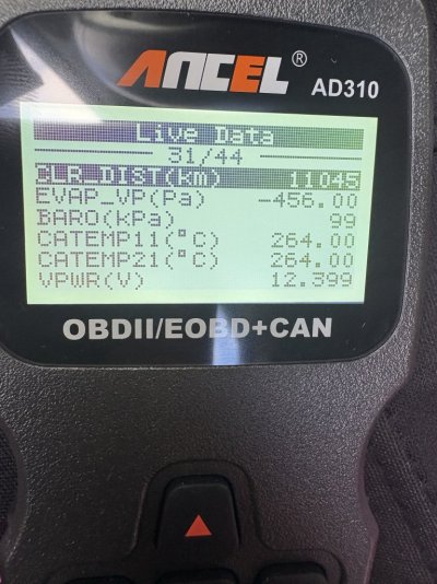

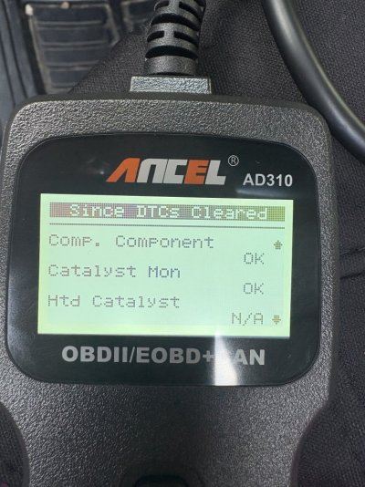

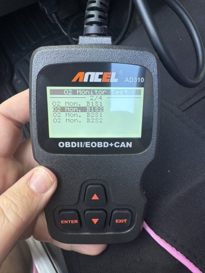

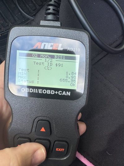

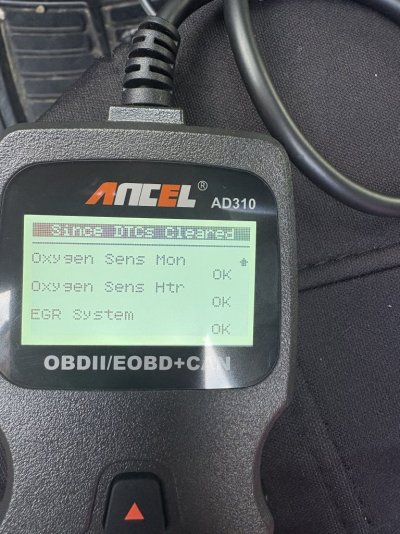

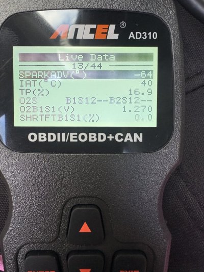

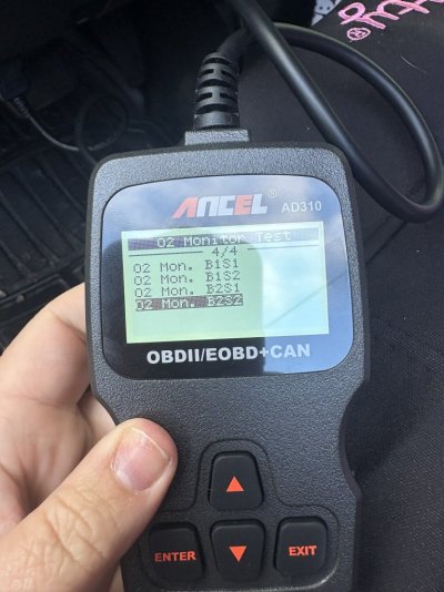

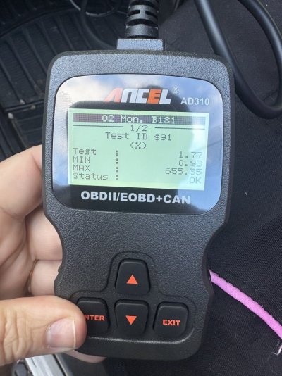

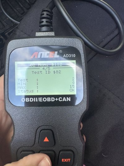

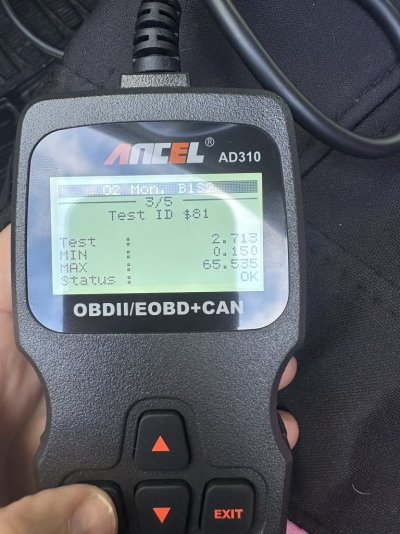

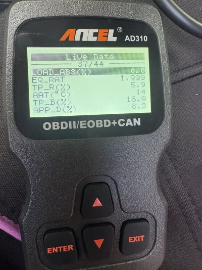

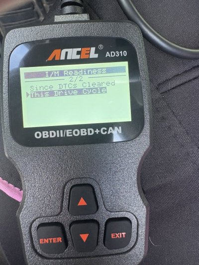

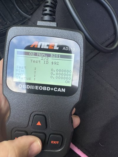

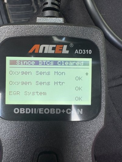

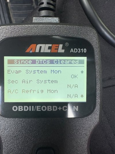

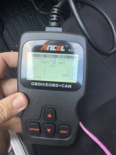

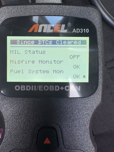

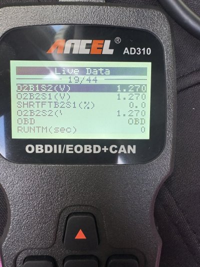

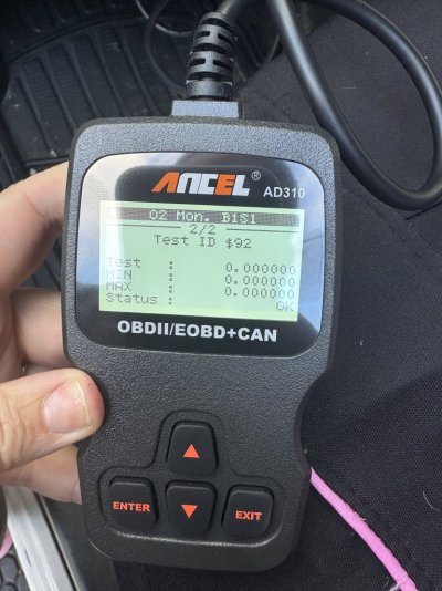

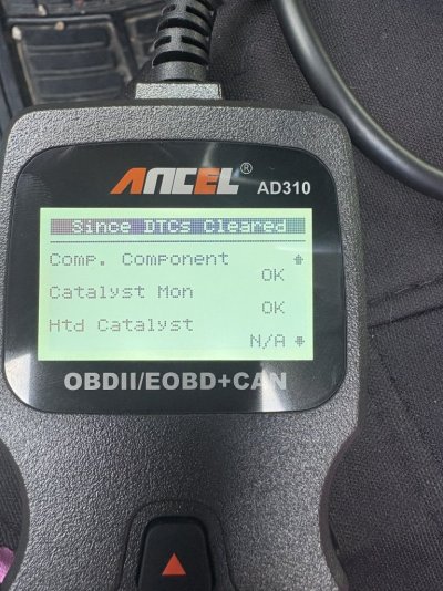

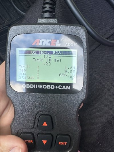

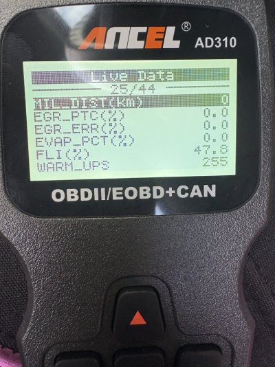

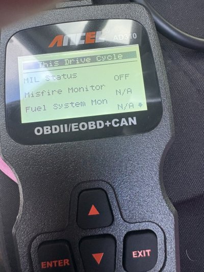

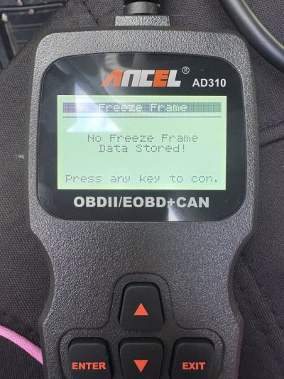

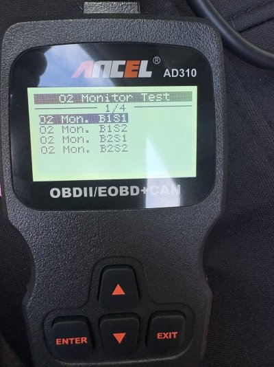

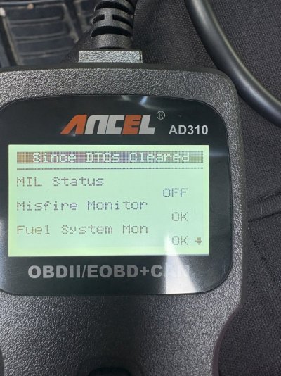

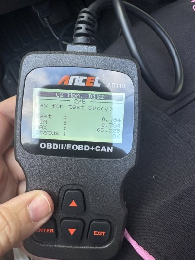

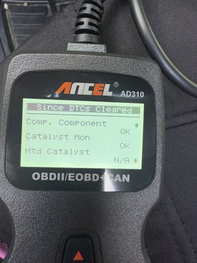

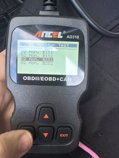

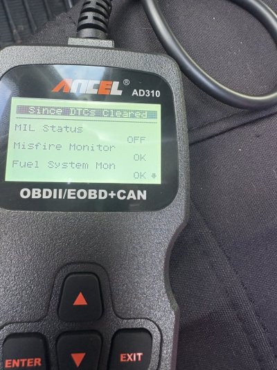

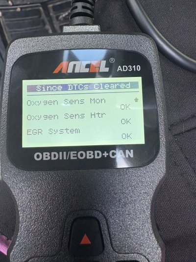

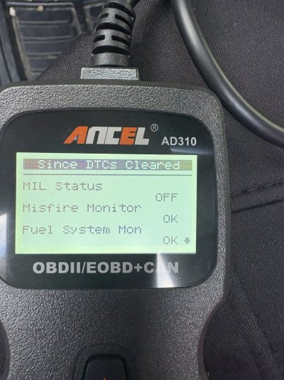

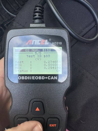

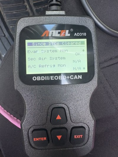

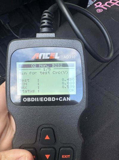

I plan on getting it into the shop unfortunately I am low income and it will take 1-2 mos to come up with the amount they quoted me just to investigate and another 3-5 months to come up with money to repair if it is the fuel pump ( or anything requiring them to drop the tank or remove the box.
In the meantime ,
I was able to get it scanned with an
ANCEL AD310 tester.
I will upload all the pics I was sent of each test if anyone wants to look through them and let me know if/what they see . If not - np :)
There’s like 70 or so pics though so I understand if you don’t
