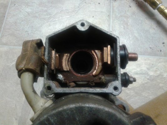

did you open the solenoid up when you had it off? good chance it may have worn contacts. if that is not the issue have you checked battery voltage? it sounds like the starter is not getting enough power which could be a low battery or bad contacts. there is no load on it while bench testing so doesn't require as much power.
I put a fresh battery in it but didn't open the solenoid up... if the contact are worn is it just best to get a new starter?

i would still recommend checking the solenoid contacts before replacing the starter. they are the most common wear part on this style starter. usually the motors outlast a couple sets of contacts.
