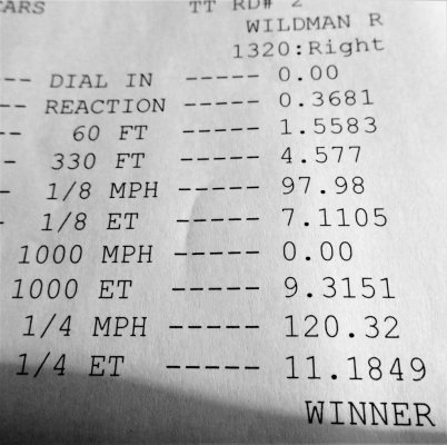

My 5300 lb 4X4 gained 2/10's at the track with everything ahead of the transfer case removed. If you're spinning in 2 wheel drive,you need more tire under the back end. On 305/17" Mickeys i pull 1.60 60 fts and low 12's at 4500ft DA. DA corrected it runs mid 11's

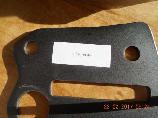

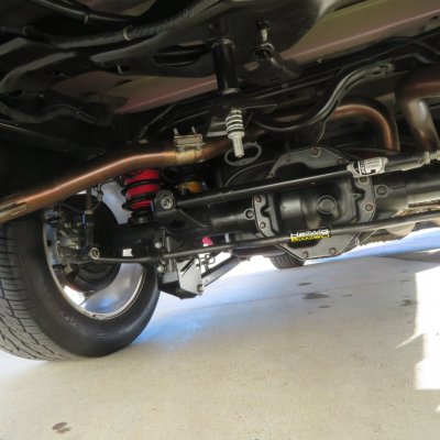

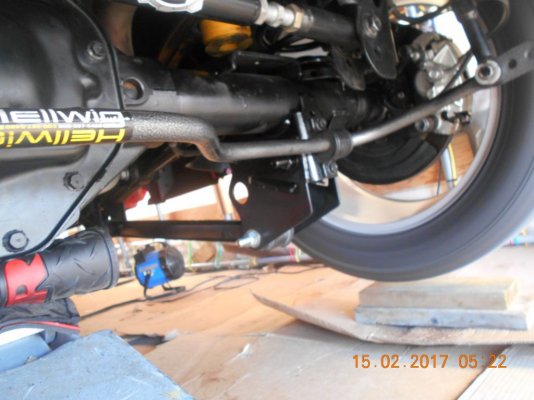

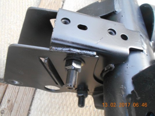

I'm lowered 2/4 and i'm running the earlier Illicit relocation brackets,which correct the geometery under the rear,and actually create body lift to force the rear tires into the pavenment on launch.My truck will hook on a skating rink,lol
Look close and you can see how the brackets move the rear locating arms down,bringing the instant center back to where it's roughly about the middle of the transmission,which creates body lift.

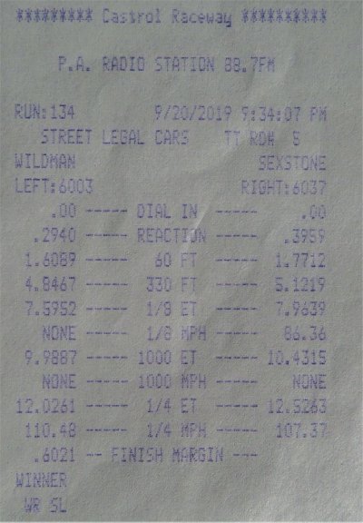

Respect. A time slip or it didn't happen, that's what I always say....
This is a slip off the wifes car,at 3500ft,it beats stock Hellcats pretty easily up here,takes a pullied/tuned Kitty to give her a run
