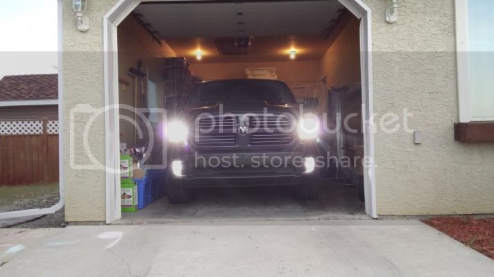

All you need is the hid kit. Bulb and harness. Down South Kustoms sell top of the line product from Diode Dynamics. This is my 14 Projectors with 6K Premium kit and 6K Hylux kit in my fogs.
