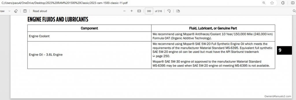

Read the note at the bottom,this is from the 700 page printed manual for my 14.
Been a car nut for over 65 years and owned about 80 motor vehicles. A number of them fast. I have never (knock on wood) had an engine failure or expense on any of them. I have always used the oil recommended in the owners manual. And change intervals. This includes cars with engines revving up to 9500 RPM. Of course, that's just me (with a 42 year career in various types of engines)

Well if you want to keep your hemi's cam and lifters alive,you'll ignore their oil change intervals and read that note realigiously. I wouldn't go anymore then at the very most 5,000 miles and 4,000 miles is even better between oil changes,and 5W-30 Redline has a proven track record of helping to prolong the life of the cam and lifters.I'm 61 and have spent the last 46 years at the track racing,so don't try pulling that old timer crapp on me,i've been around the block and down the track more then a few times myself,lol

The manual in your truck recommends 5W20 but says 5W30 May be used.
I run 5W30 and no lifter noise on my 2021 Ram 5.7 where I had noise at 900 miles.
