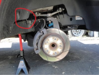

Ok, double verification. Run your VIN and get a build sheet: https://fcacommunity.force.com/RAM/s/equipment-listing
Then remove your right front wheel and look to see if there is a plug behind the plastic in the circled area.

Thank you - that answered that question. So I will inspect/test the rear tone ring.
