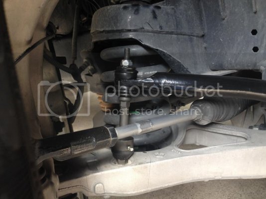

I think getting the front sway bar back to a more parallel angle to the road really helps. With the factory links the front sway bar is no where near parallel to the ground as it should be. The Moog links don't get it perfect, but they get it much closer than the factory links. The links area easy to change. I found it necessary to use both the factory bushing cups and the Moog bushing cups to get the right amount of compression on the sway bar bushings.
Your front bump stops should look like this! You have to cut the factory bump stop cups off, then install the BellTech bump stops.
