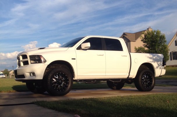

Not sure what blocks you are talking about ... Mine is a 2012 with a Zone 4”F/3”R with Bils at 1.4” on 35’s with 0 offset 20” X 9”08cd7d69ced5657e3abbd5edda63936c.jpg
Great looking truck! I love the oversized look with the factory offset. Makes it look clean to me. Not too tall but just right.
