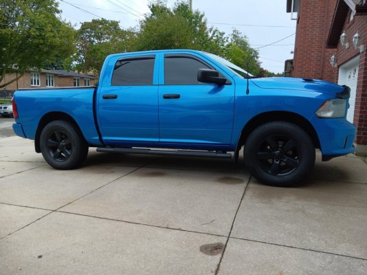

I'm running Michelin Defender LTX M/S LT295/65R20's on my stock 20" rims and all I have are 5100's all around with the fronts set to 2.1" raised, on stock front UCA's and all four stock springs.
This tire size equates to a 35" OD and I have zero rub issues with full turn stop-to-stop.
Excellent ride and full control with zero issues.
*Edit* I have stock 3.21 rear gears and my 19' runs flawlessly and gets great mileage. I mostly run highway as my career has me all over Ontario on projects.
I'm also personally not a fan of spacers. This size of tire pokes out well on the stock hubs and looks fantastic IMPO.
I have a fat finger width between the inner tire side and my UCA outer edge with my LT295/65R20's.
Any wider a tire and it's a real gamble if there would be enough safe space without the use of a spacer not to rub on the front UCA outer edge. Again, for me a spacer is a no go. I personally don't like to extend a stance on parts that have the potential to add a margin of error and gap for safety. Not condemning anyone using spacers, but for me the juice ain't worth the squeeze ;)
