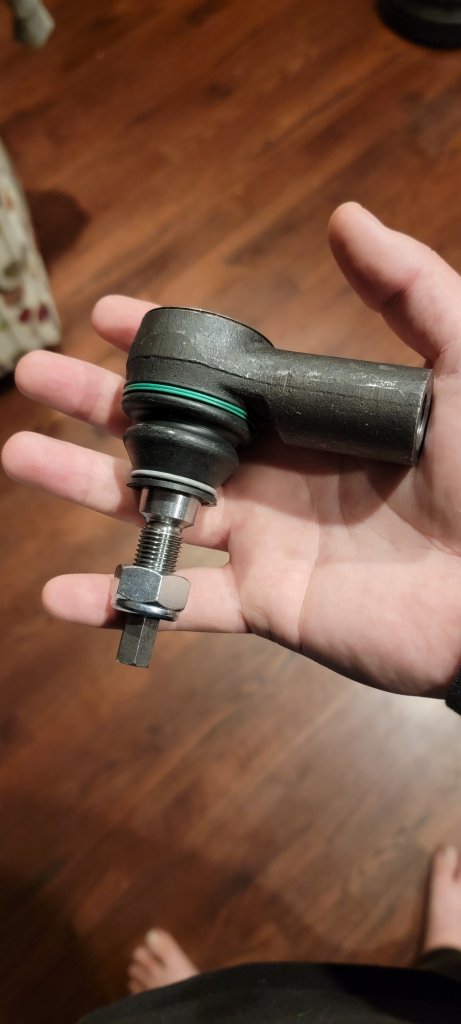

Do you know the part number for the tie rod ends you got? I ordered BDS:082603 and received these, which aren't what was pictured and these have no zerk fitting.

One of my tie rod ends puked a boot about a year ago (maybe 45K miles on the lift). The shop I take my truck to was able to get BDS to warranty it out for me. It's similar to the one pictured... No grease zerk and matches the one that was already on the truck.
no grease fittings on 2013 + Classic models
