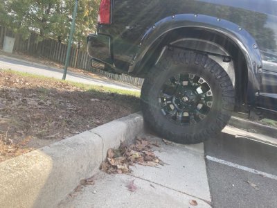

I did a mbrp cat back on mine with with the “louder than stock but not aggressive” wanted the deep sound at idle & louder when you get on it, been very happy with but I also added some 5” tips. Lots of members have added mufflers to the stock exhaust with good results. Either way I would contact Nick @ Gotexhaust a vender on this forum & was a big help to me with info & great pricing4619792B-8754-40D4-917B-F6138FD36BCD.jpeg
