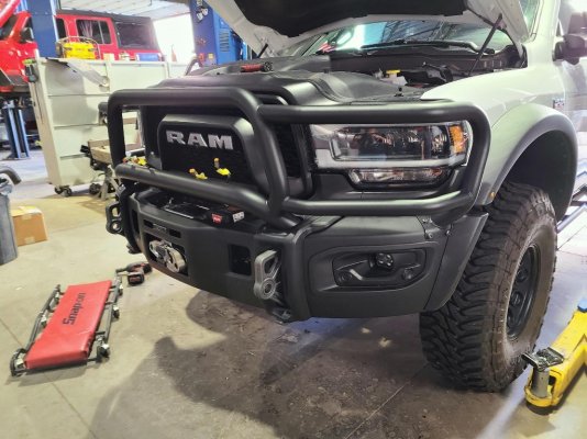

I installed 5:13's in my 2020 PW in May of 2020. Only difference was rear pinion bearings and front pinion seal. Have 21k on gear sets with no issues.
Also installed the Titan remote fuel tank in spare tire location. It works!! Screenshot_20221010-210706.pngScreenshot_20221010-210653.png
If the album doesn't share properly email me.
https://photos.app.goo.gl/wjoocK7np8ve3R6o9
Also installed the Titan remote fuel tank in spare tire location. It works!! View attachment 504057View attachment 504058
That is one bad ass drool worthy build! You checked all the boxes, taller gears, auxiliary fuel tank....
