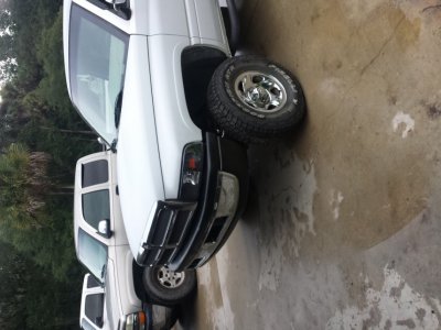

Little update, I finally got around to fixing my bumpers saggy tit ends and repainting the plastics black uploadfromtaptalk1440182009647.jpguploadfromtaptalk1440182101749.jpg every tab that held the ends down were broken so a little panel bond solved that. In other news are any of you Florida boys going to the 4 wheel parts truck and jeep show on Saturday?

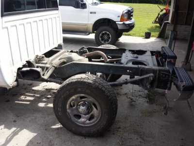

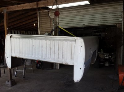

So over the weekend I decided that beds suck so I took mine offuploadfromtaptalk1444678905431.jpguploadfromtaptalk1444679314837.jpg but then decided to change what I thought was a failing fuel pump. It wasn't, it was a worn shrader valve that would let air in and take forever for the truck to start.
