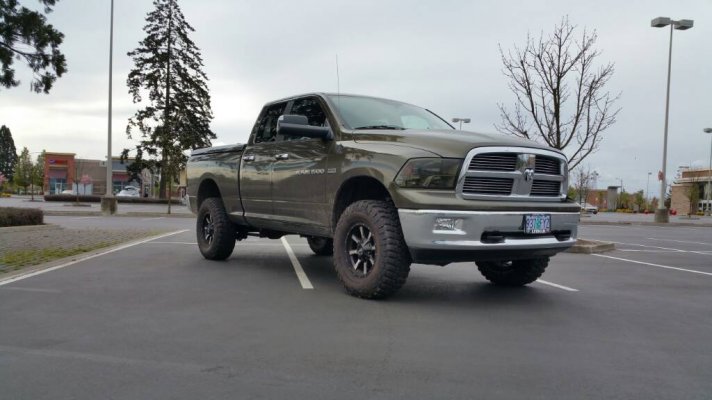

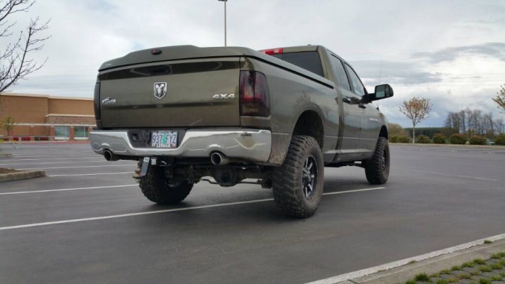

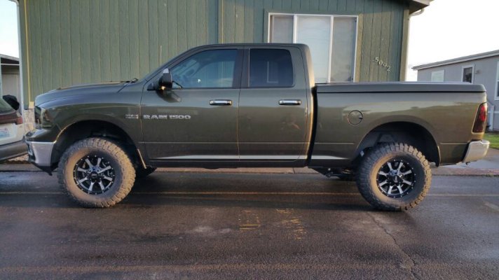

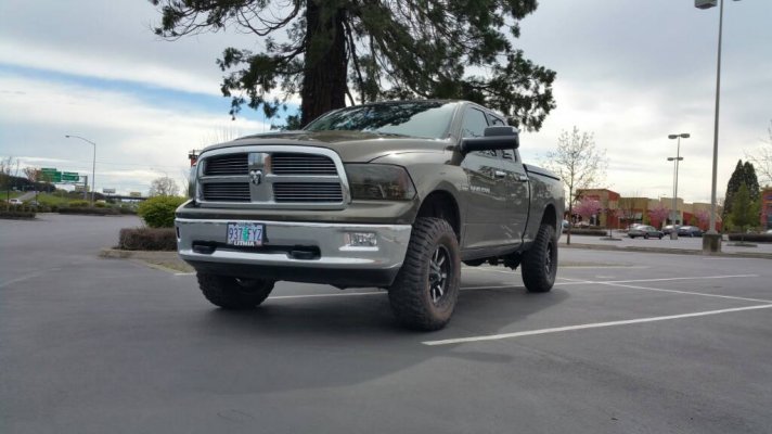

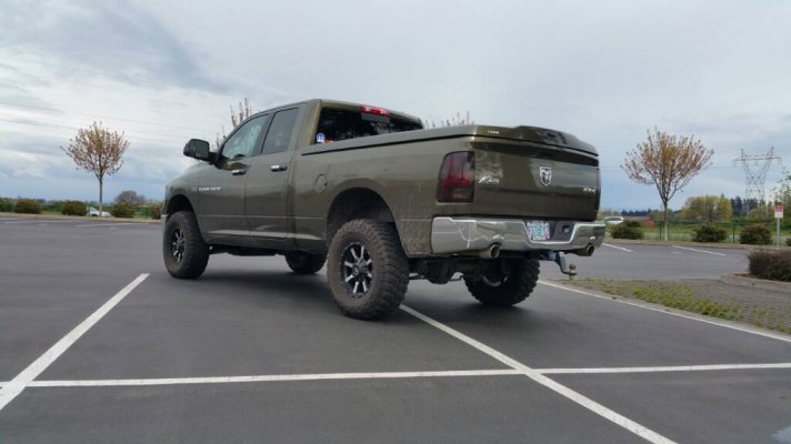

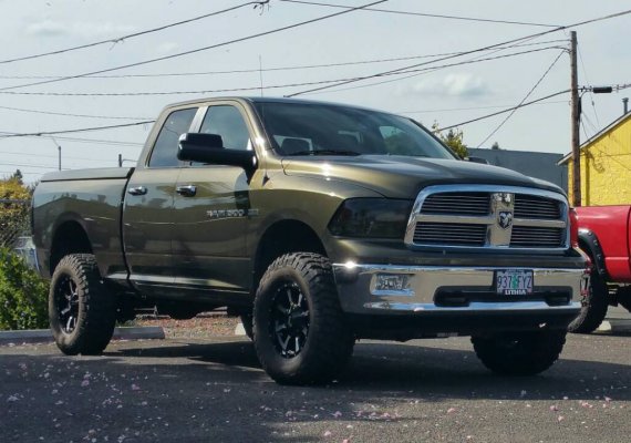

I for one am really happy I got the 4" with the Bilstein's because when I initially installed it I had them at 0 and had 2" of rake. If I got the 6 and had the same results, and leveled it out, 35s wouldn't look right lol. But if you want 2" of rake, maybe a 4" w/o the Bilstein's? Here's just my 4" on 305/70R17
Looking good. What size and make wheels u running?

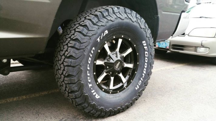

Thanks! She looks even better with 35s and my Bilstein's at 1.4! Wheels are
Moto Metal 970s
17x9
0 offset
4.5 backspacing

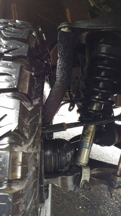

These rims are 17x8. According to every specification I can find anywhere.
I thought they were 9", my bad. Still work great with the setup!
Juvenator93
Oct 8, 2014
521
288
Ball joints, knuckle, and caliper have lots of room. At least 1/4"
