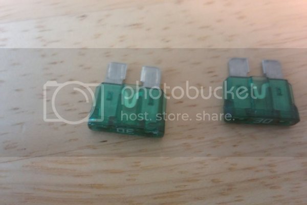

Well my sub cut out yesterday. figured it was blown fuse but it doesnt look like it. the fuse for the wiring is good. I check the wires all were fine. Aaron said to pull the amp fuses and I just did that. they dont look blown... idk whats wrong...
pics are of the amp fuses

id start with the obvious is all the settings right on your dash unit? then check the under hood fuse for the amp as you already checked the amp fuses they look good if you have a digital multimeter you can test them to make sure they are good fuses have gone bad with out visible signs, then if all that is good you could take the sub out and test that with your digital multimeter also on a ohms load and see what it reads....thats where i would go....

I second this, because I had this problem. I was listening to the stereo and all the sudden the sub quit and the amp was not turning on at all. Took me days to figure it out because I checked the fuse by the battery and it looked good, and some how I got 12v across it with the volt meter so I ruled it out. After scratching my head just as a last resort I bought some fuses and replaced it. The sub worked fine then.
