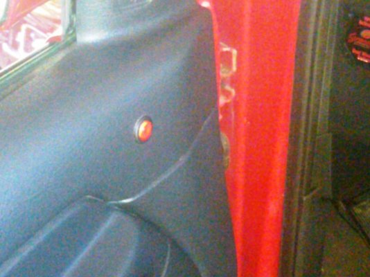

Will this work on a 04 1500?
I know this will work......
It's a toggle switch that interrupts the door switch which kills the "Ding Ding".
