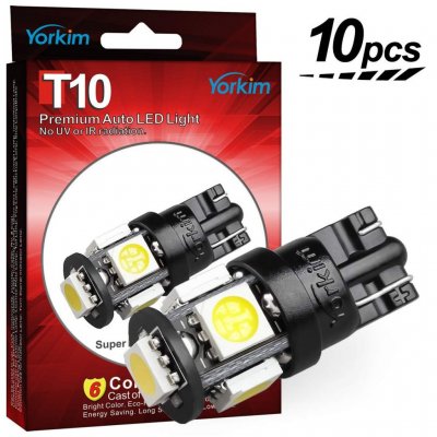

10-LED bulbs.jpg In stalled these to day from Amazon, overnight shipping, gota love them peeps.
