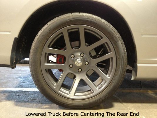

what UNBROKEN is telling you is that when you lower our trucks the rear wheels shift forward due to the control arms. here is an example...
this is what you need to correct that...
and

Hmmm...those pics look familiar. lol
