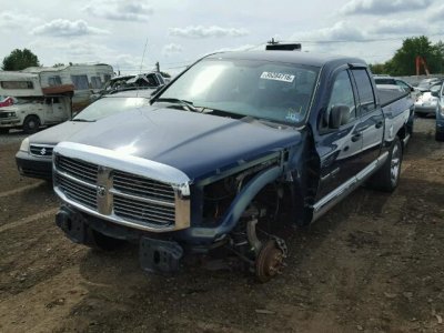

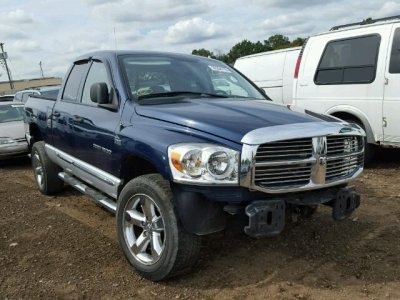

    Hello new friends, I just purchased a 07 Patriot Blue Ram 1500 quad cab Laramie 4x4 with 3.92 posi rear end! :happy107:
    That is the good new, The bad news is it took quite a hit in the drivers front area. From my very quick post purchase inspection it looks like it will need front fender and bumper assemblies, along with quite a few front suspension bits. At a minimum the lower control arm has snapped at the mounts and the upper control arm ball joint popped. That is what is initially visible. While all the mounting surfaces of the parts look to be in good shape, I am sure I will find more damage somewhere with closer inspection.
    While I might not necessarily mod this truck just for the sake of modding, I always look at every failure as an opportunity for improvement. I am viewing this damage as an opportunity to redo the suspension and possibly get a really cool new bumper and or a better than stock look in the processes.
    With that said, I am looking for help in identifying the best replacement parts and components to rebuild. Can you help to point out the best parts and vendors to use in rebuilding a vehicle with this kind of damage? Would you know of area I should inspect more carefully for less obvious damage and/or ways to test component stress?
    If it helps to guide your recommendations, I plan to use this truck as a hunting and fishing rig towing a 26' power catamaran hull to destinations when not hunting some back country. :waytogo:
    Attached are the starting pics for my new build.

    My truck was hit just like that but harder when I bought it. It had to have the frame pulled behind the fender. It's easily fixable though. Just look around for any stress fractures or things like that. Take a good look at your control arm mounting points. You said they looked okay but another set of eyes can't hurt. I say if you have the money to fix it go ahead and go aftermarket on stuff. If it were me I would go ahead and lift it, put new wheels and tires, and an aftermarket front bumper with leds all over it.

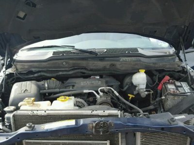

    Finally I was not able to get the vehicle to start. I am guessing there is some emergency fuel shut off circuit breaker somewhere that trips when the vehicle takes a hit. Would you or anyone know if an 07 has that feature and if so, where and how do I reset it? If not, any other ideas on what would cause it not to start? I checked the codes there were no codes set.

    No there isn't a fuel shut off on these trucks or at least not one that I know of. I'm used to seeing those on ford's mostly. Like Silverstreak said it's probably a disconnected wire or something like that. Does it have power? Does it turn over?

    Can you put a fuel pressure gauge on it and see if it has fuel pressure? A hit like that could knock the sending unit out of wack in the fuel tank. Also, it does have fuel correct? If it sits long enough it could be incorrect on the cluster as to if it has fuel, expecially if somebody has siphoned the fuel out with it sitting at that lot.

    From the looks of it, it seems that you lucked out and only needs an UCA as far suspension goes... Then you need headlight, fender, fender liner, Laramie bumper and chrome bumper trim piece.
    Forgot to add that you might need a leaf or two for the back, no telling how long that truck has been sitting like that, if you can get more and better pics we can go from there. Like, Derek said, make sure you have fuel pressure, that truck should have remote start on it so if you stand by the fuel door when you press it twice you should hear the fuel pump prime and then start (at least try). If you pull the fuse lid off check that all the fuses are good, I don't remember which one I blew during my modding adventures, but I got a similar result and it was a fuse.
