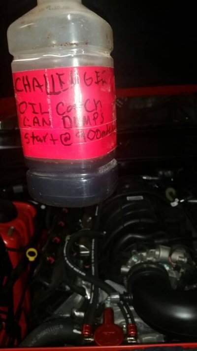

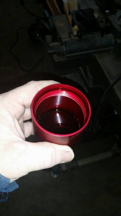

First dump was with approximately 2k approx 8.5 oz.
Next was also about 4k approx 7.5oz

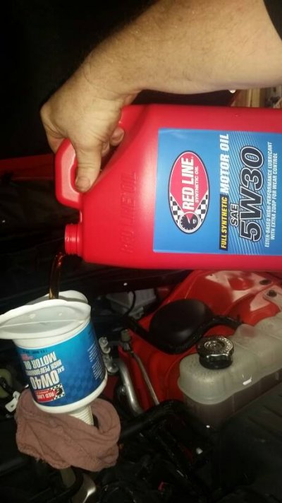

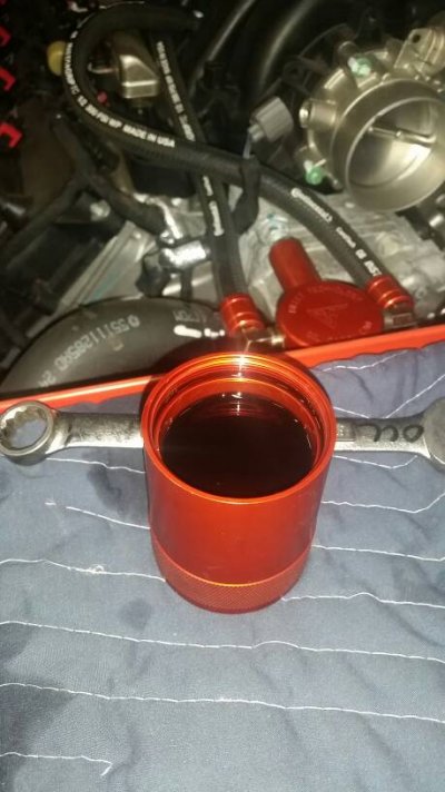

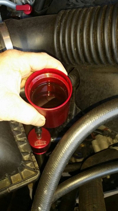

The next photo I had dumped it and went on a 1500 mile round trip 95% interstate @70-75mph . I'd say about 3oz
I notice each time it smells of fuel , just a bit ? It won't catch fire , I tried to ignite it [emoji38] anyway this is my experience and I'm happy with the results and not having all that oil / condensation in my intake plenum .
