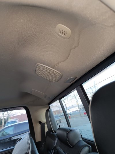

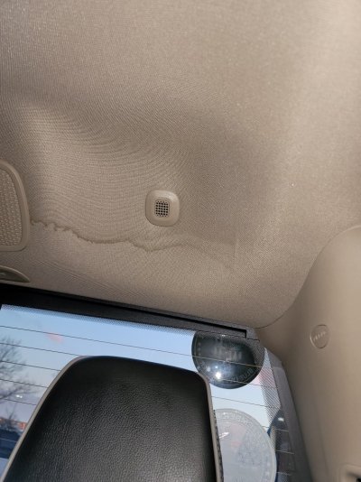

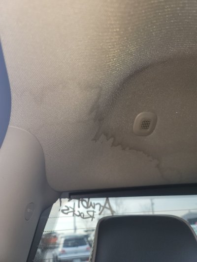

Found my 2020 with leaking water into cab. I can only assume its coming from the 3 points of interest that Ram is aware of.
Antenna, 3rd light and seem on roof. It can also be the window itself which i doubt and i read someone saying the door weather stripping. This should be a recall since this is a hazard to air bags, seat belt tensioners, electric short or shock plus the mold and mildew. Im under warranty still, but they want me to pay for rental and keep vehicle for over a month. Ram knows this issue is in all models and years but they quietly fix them. instead of sending a recall to fix issue before the mess and customer complaints.
