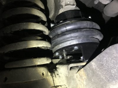

I got my Timber Grove ASAM installed last night. It would have gone faster if I had the ratcheting box end wrenches. Kind of a ***** laying on your back and reaching that high to tighten the nuts up. I ran the air valve through the license plate instead of in the box. It was easier to run it out the back. Everything is clear of the exhaust pipes. I added 70psi to check for leaks and there was none thank God.
Aired everything down and got the weight on the wheels, put about 20psi in it and it raised the rear pretty significantly. Dropped it to a little more than 10psi and took it for a ride and it definitely stiffened up the ride, but not horrible. Felt a bit more solid in my opinion.
Need to hook up the camper and figure out the sweet spot for the amount of psi needed to keep everything stable.
