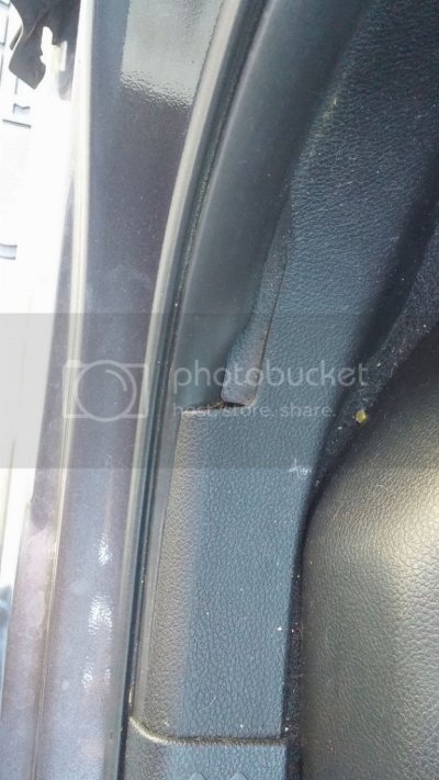

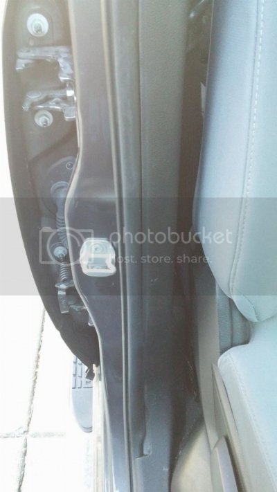

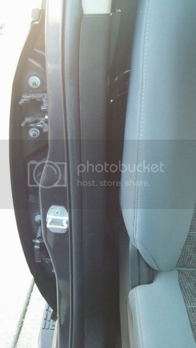

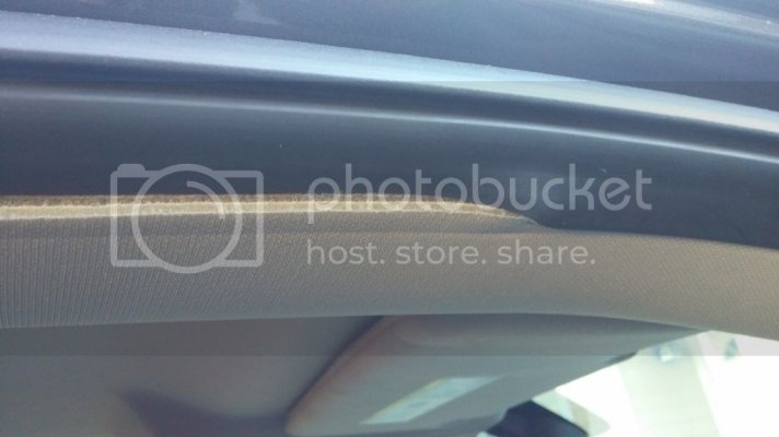

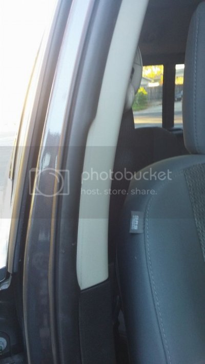

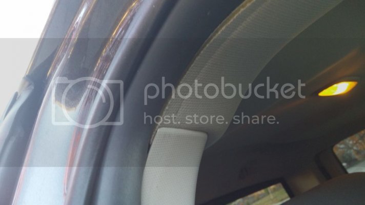

Just got mine back, dropped it off at 9 got it back at 3
fyi not very happy,
These are pics of the passenger side
So took it home, opened the door and saw the black weather seal all fubared, i say whatever shrug it off and tuck it back in - almost 50% of the driver side was not tucked - also the b pillar plastic cover was not locked in - i popped it in while correctly re-seating the weather seal.
Jumped over to the passenger side, even worst...... Now 75-80% not tucked in, the top headliner is drooping beyond the weather stripping, and again the B pillar not popped in.
Monday morning is going to be a fun call with the service advisor, and it may get escalated to his manager.
I used to be a mercedes tech, considering this was warranty work and the tech left the truck the way it was presented to me means hes doing this to every other truck he touches.
They were lucky I picked up my truck in a hurry, they had it parked against a fence, so i couldnt even open the passenger door and look at anything, and my driver door was opened into the service driveway exit - so I didnt do any inspection and drove off and left in a hurry.
Bottom line - they did not treat my truck like it was theirs, $35k is my hard earned $ and they put it back together half assed.....
Being warranty work is even worst, I loved warranty work as a tech - you do the same **** over and over again. I just cant believe this type of workmanship is done at a factory dealership. Its as if the tech took off my tires and when he put them back on, never torqued down the wheels - all of my interior was reinstalled 1/2 assed, which automatically leads me to believe the entire job was 1/2 assed.
