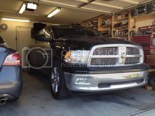

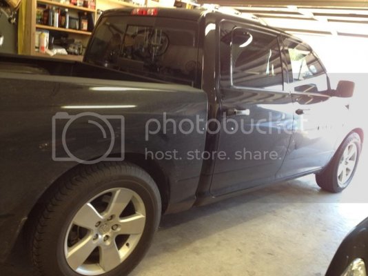

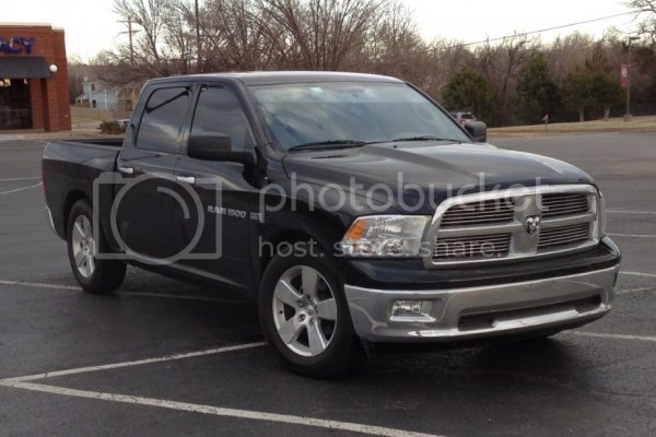

sorry for the quality. we are expecting a "blizzard" later today through tuesday. so the truck is still dirty from the snow last week
before
after
