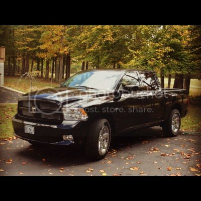

Heres mine just to give you something to look forward to
Uploaded with ImageShack.us

thats is an awesome stance! and which bolts are you talking about? Cant wait to put them on! but all this talk about cv joins coming out and bolts stripping lol not good. when i had my ford i put on a leveling kit myself. didnt seem too bad. And the 33's i have are going to look perfect in my opinion. I like the thinner + rugged tire look. Esp with just a level/rear spacer
