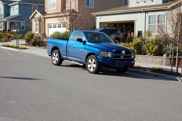

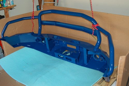

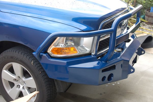

Well the hardest part of the install was transporting the bumper back and forth to powder coater's and the removal of the old bumper. Got two scraped up knuckles on the middle fingers and one busted nail, but none of that was on the install which went really smooth (with exception to fog lights).

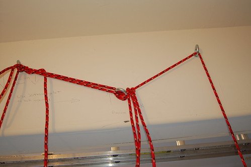

First and foremost, suspending the bumper from the ceiling is the absolute way to go and I literally drove the truck right to the bracket and the bolts went right in with zero issues.

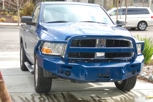

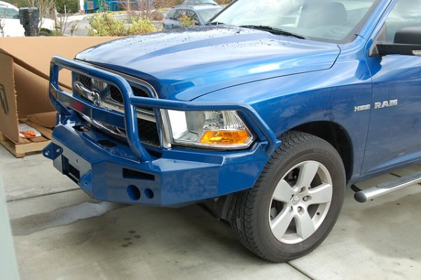

Pro's of the Fab 4's Bumper
* One of the few available for the 1500
* Heavy Duty
* Fits like glove with just enough room to not mess up fenders
* Improves Clearance from stock
Cons
* No optional wiring harness for fog lights, really ****** me off!! Why doesn't anybody care enough to make a harness that plugs into factory fog lights??

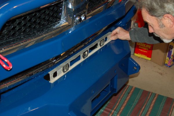

Tips, you need two buddies one on each side when fitting the bumper. Use sockets because it is a little tight under there. Levels actually work when you use them! Having a wife around to be in the way and constantly be in your business is optional, but not necessarily recommended.
Final thoughts are I like the bumper and feel like this should be a factory option. I'm sure many guys would be paying an extra grand or two to get these from the factory. I can't believe how close Miller Powder Coating got the color match, they did a great job.
The truck drives the same, you cannot tell at all their is a different bumper on the truck from behind the wheel.
