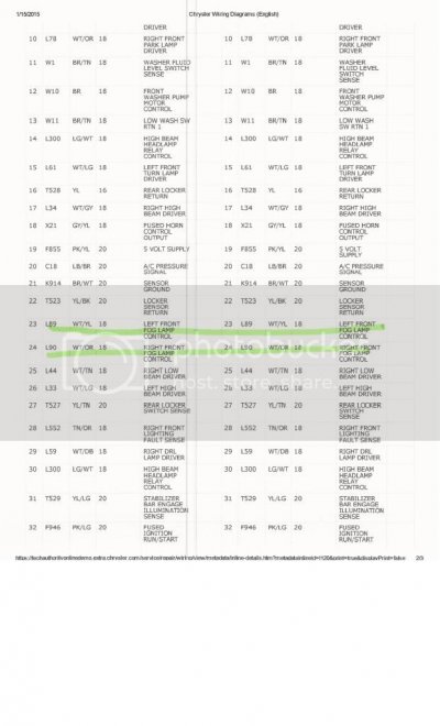

3- cut the end off the jumper, tie the 2 grounds together and find a good grounding point. Then extend the 2 leads to the tipm (or whatever it's called now) and tap into the foglight feed wires in slots 23 and 24. They will be white/yellow and white/orange. Be careful because the headlight wires are the same color.

Its weird, according to the drawings for the wiring diagram, the fog lights do not go to the PDC. they run through a couple connectors and then to 2 different connectors on the BCM. not sure what you tapped @ the PDC.

I thought that at first but after a few days of studying every diagram I could find, the fogs due go to the PDC.

Here are some pics for reference
PDC
This is the end of the jumper

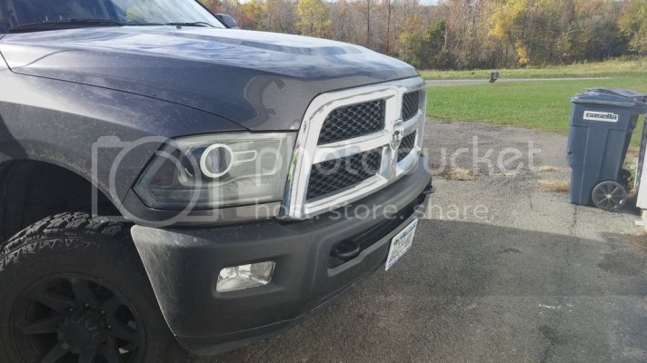

Love your main headlights are those stock?

The headlights are oem. I opened them up and painted them myself.

On the main harness side of the pdc will be the feed for the fogs. Just tap into those. I'd have everything done prior to having the sales code added makes trouble shooting easier at the dealership. I had it added when I had my remote start added and didn't know until everything was installed that for some reason it didn't take. Showed on the computer it was added. Took the tech 3-4 tries before it stayed.
