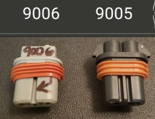

Anyone know what the factory plug/bulb is at the back of the fog lights (2013+)?
I assume its a 9006 or something like that; it would be nice to id the yazaki or tyco PN from TechAuthority.
EDIT: Looks like its 9005 (2 slots/orientation keys)
The bulbs in my 16 spot fogs are 9005.

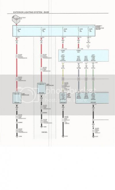

Mopar hasn't released a add-on Foglight kit yet like they did for 09-12 trucks and I'm not sure if they will have a separate section of the foglight jumper harness available anytime. So for now you have 3 choices.
1- buy the complete headlight wiring harness for around $150 (I think) which has the pig tail connection for the foglight jumper. I have no idea how hard swapping this one in would be, or just steal the wiring for the fogs from it and install them onto your truck.
2- find the female connector and the correct size pins for both ends(I think, don't remember which one it is) and build your own harness
Or what I did
3- cut the end off the jumper, tie the 2 grounds together and find a good grounding point. Then extend the 2 leads to the tipm (or whatever it's called now) and tap into the foglight feed wires in slots 23 and 24. They will be white/yellow and white/orange. Be careful because the headlight wires are the same color.
It may take the dealer a few tries to get the sales code to stay. It took 4 or 5 tries before mine took.
Everything will function as if it was installed as a factory option.
If anyone has any questions about any of the install feel free to ask. I'll post some pics of the wiring and diagrams later.
Here is a link to where you can access the wiring for 2010+ trucks
https://techauthorityonlinedemo.extra.chrysler.com/service/repair/wiring/view/classic.htm

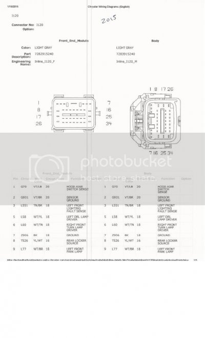

i did read , but i only found the pins regarding the gray module connector , unless i missed it somewhere
my friend 2015 SLT has the gray module ! , idk whats Ram doing its confusing

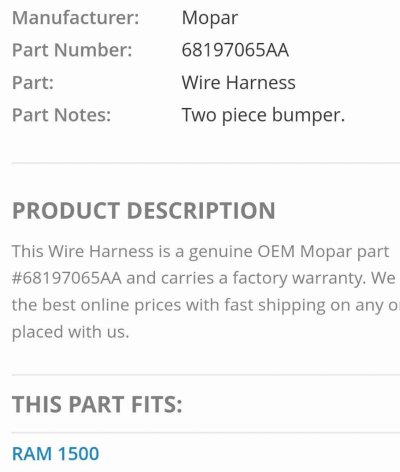

Looks like there is a different foglight jumper harness (bumper) for 1500's vs 2500/3500's. Pinout is the same, but the actual bulb connectors are different (9006/1 key vs 9005/2 keys)...
68197065Ax , 13-14 1500's
(9006 Sgl Keyed/1 groove)
68046303Ax , 10-17 2500/3500's
(9005 Dbl Keyed/2 grooves)

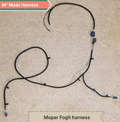

Small Update.
We now have a "Foglight Extension harness" that I have sent out to Deereguy to be tested in his 2016 2500 truck to help finalize a write up/install instructions. Next will be to build one for my 2013 1500.
This will allow you to buy the official Mopar Foglight "Jumper" harness that goes into the bumper and plug in the "Extension" harness that will install in the factory connector under the PDC. As close to the factory wiring as you can get.

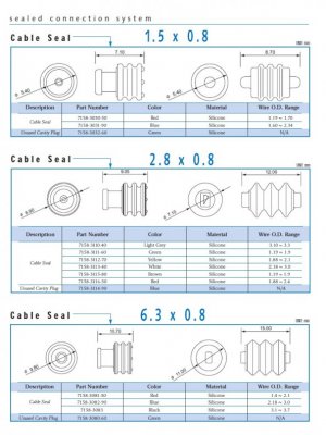

EDIT (5/23/17): ARRGH! So close. I have the wrong wire seals (too big).
Looks like this...
