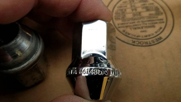

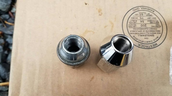

After seeing this video, https://youtu.be/unAAHWtaQ0o I realized I have the same type of lugs on my truck. So before I had to deal with getting a rounded lug off without destroying my wheel, I decided to get some Gorilla Nuts. The stock lugs have a thin metal sleeve that covers a relatively soft steel nut which rounds off way too easily.
The part number for my truck and I believe all 2013+ trucks with 20" wheels is GOR-66148DX. The specs of these are M14 x 1.50RH. These are actually cheaper than the replacement Mopar lugs.

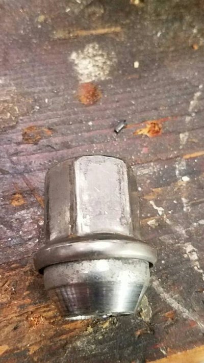

This is one of the 3 that got stuck in the socket. Hard to see in this pic, but it's starting to round off under the sleeve which caused it to jam in the socket. DEFINITELY use a 6 point socket for these.
The dimple on the top is where I used a 1/4" extension to pound it out of the socket I was using.
Can't believe these are this soft.

Isn't that the chrome cover ? I don't think that is the actual lug nut , it's just a thin chrome cover imo .?

It is a cover but it's integral to the nut itself. Funny thing is the cover or sleeve seems to be harder than the nut under it...

I do agree The factory ones are junk.
My last Dodge truck had the same **** .
I always rotate my tires myself (ha ha did this today in fact )
I always use a 6 pt socket and I don't use my air impact on them because I'm afraid I'll **** em up !
I do like those Gorilla ones !
