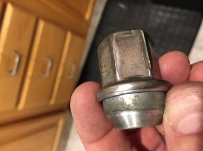

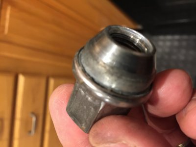

I received my Gorilla lugs yesterday and installed this afternoon... these lugs are really nice...solid...the way they should be! Upon changing 2 of mine got stuck in the socket... what garbage...it's like when you first discover the chrome clad wheels are plastic and fake. Who would of thought the lugs too...as they age you are prone to have more trouble with them. I am sooooo happy I found this thread and changed out with a high quality solid one piece lug before any trouble...I can't imagine torching them out like the the video the OP made. I even put a tiny bit of anti seize on a Qtip and worked around the threads of all the new lugs prior to installing. I now know I am good to go if I ever need to change the spare. I also hand torqued to 115ft lbs. I highly recommend everyone switch these out...best $50 insurance you can spend! Here is a pic of my 3 year old lugs...they are showing a little wear in the seam area.

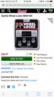

I like the gorilla lugs sooo much that my oem locks looked out of place....so I ordered a set of matching gorilla locks as well! These come with a socket key... not the cheap factory insert crap that came with truck. Now all will match!!! $27 on eBay
Part number: 96641DX
They also have in black as well.

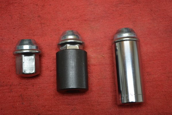

Read this thread and got pretty concerned, like most others, that these factory lugs could become a nightmare some day. I have 4 of them that have only been removed once and looking these over, I have some thoughts:
The lug on the left already shows some stress from the regular socket I used to remove it. The regular socket does not slip all the way onto the nut. It only goes on about 3/4 of the way until it bottoms out. A deep socket goes all the way on. Also, the correct socket size is 22 MM. A 7/8 socket seems to fit but it is 22.23 MM, a little bigger than the 22 MM. That may not mean much as quality control on sockets is probably not that close. Unless perhaps sockets by Snap-On.
So, I think that if you use a quality deep 22 MM socket, and avoid using a rattle gun, the factory lugs will be fine for a long time. Break the lugs by hand with a big breaker bar, and set the rattle gun on a low torque to run the nuts on and off, but final torque them by hand.
