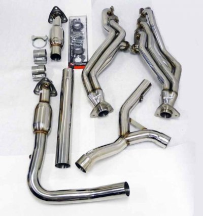

Below is a picture of the Challenger parts (these are mine -- and for sale, but would re-use them if possible).
Challenger 6.4 SRT Manifolds + SOLO Mid Pipes/Cats:
Flowmaster Exhaust for Challenger (to show how it carries on -- notice no Y pipe):
OBX Setup (07-08 Ram):

OBX headers for a 06-08 SRT Jeep should fit with minimal modification.
O2 extensions will probably be needed.
I had Kooks longtubes on my 2011 that were off an 06
