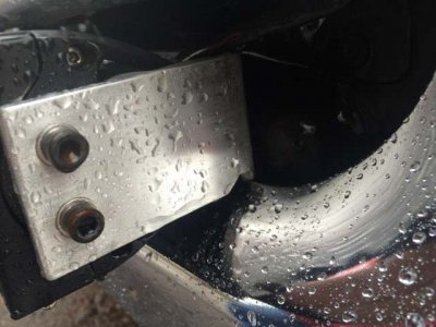

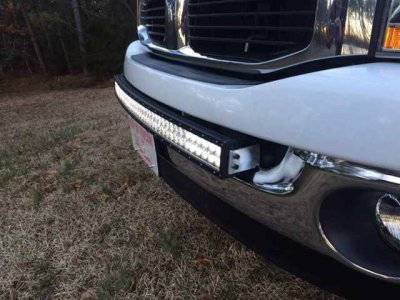

Well the ends of my bar have the two screw mount style rather than the one on each end with spline type setup. The slots are in the wrong place for me to mount the bar like I had planned. Looks like I'll have to modify the mounts or either make new ones. And to top it all off, they forgot to include the switch and wiring harness. They are supposed to be sending it though.

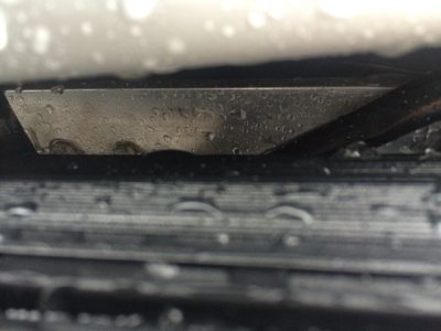

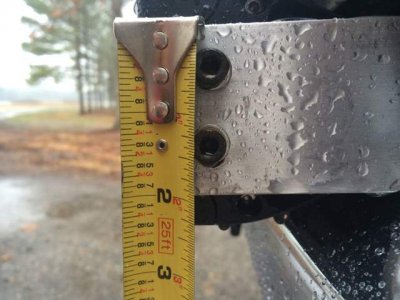

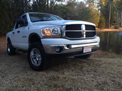

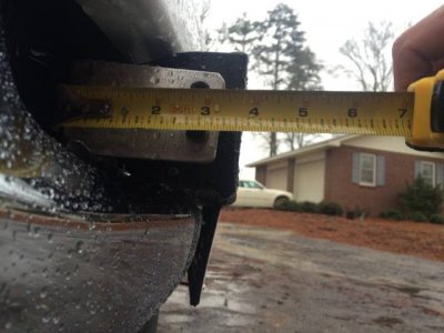

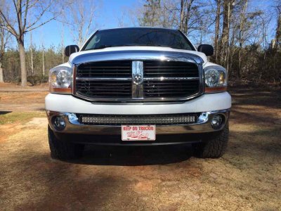

Looks great good job! Can you get a closer shot of the bracket you made?
Mr_Nacho
Mr_Nacho
Jul 21, 2011
190
Saluda, S.C.
2006
4.7
I don't have any of the brackets by themselves but I will get the best shot I can of them and post them.

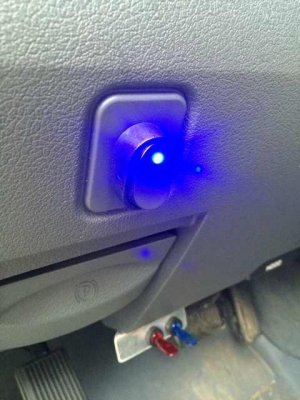

Yea whatever picture you can get would be great! How hard of a job was installing/wiring? I am a complete noob to auto electrical, but want to install one of these.
Mr_Nacho
Mr_Nacho
Jul 21, 2011
190
Saluda, S.C.
2006
4.7

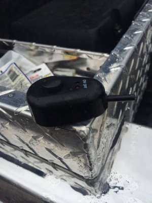

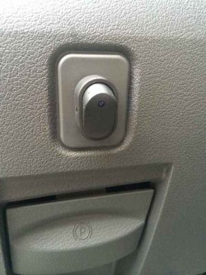

It was not hard to wire at all. The only thing I modified on the harness that came with the lightbar was change the switch. It was a big cheap bulky one that mounted with sticky tape. I cut it off (1) to enable me to drill the smallest hole possible in the firewall and (2) install a better switch in the delete plate where some trucks have the power adjustable pedal switch. I am assuming you don't have tow hooks either?
