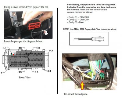

Looks like the new v17 radio software update has the backup and cargo (CHMSL) camera inputs swapped (to match the setup on the 16-17 radios).

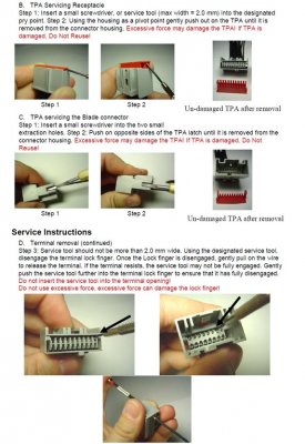

Not sure if either of you are willing to post a picture of the back of your radio connector that clearly identifies the wires/colors at the 2 camera inputs, but it would help a lot.
Just a minute...
Original inputs (13-15 radios... w/o mirror bu cam)
______ (Sig / Sig Rtn / Shld)
Backup Cam: 31 / 32 / 33
CHMSL Cam: 21 / 22 / 23 (via CustomTronix Jailbreak)
Front Cam: . 24 / 25 / 26 (or VES via CustomTronix Jailbreak)
Edit:
Your Factory 2014 truck (CHMSL & Bu Cam Mirror) ...
CHMSL Cam: 31 / 32 / 33
Backup Cam: Mirror display
Spare input: . 24 / 25 / 26
NEW 16-17 Radio Setup (& radios w/ v17.x SW)
Backup Cam: 31 / 32 / 33 (if not in Mirror)
CHMSL Cam: 24 / 25 / 26
Front Cam: . 21 / 22 / 23 (VES - Req's custom SW or module)
Swap 31,32,33 with 24,25,26 and report back.
Reference post from camera thread for getting the pins out...Installing OEM backup cam - Page 3 - DODGE RAM FORUM - Dodge Truck Forums
M² Mods - From my non Flammable S7!

1. To get the cargo/CHMSL cam to operate correctly, I should move pins from 31, 32, 33 to open/spare positions 24, 25, 26. Then when selecting the cargo cam I should get the video feed correctly under the default cargo cam toggle button. If I then toggle the onscreen button to the rear back up cam I’d get the blue screen since nothing is connected to that input. However, shifting into reverse would activate the rear back up camera in the mirror, as usual.
2. If I wanted to have the rear backup cam on the radio screen, I’d need to reroute wires from the rearview mirror jumper connection to the radio, open positions (assuming above was done) 31, 32, 33. Mirror screen would then be dead, but other mirror functions intact (dimming, 911/Assist). Two questions: a) where is the mirror jumper connection located? b) where is the reverse signal that tells the camera/mirror to power up coming from if I am rerouting to the radio…I get how it powers up via radio when manually selecting rear cam, but not exactly how it activates in reverse after reroute.

I pulled the radio and moved the 31, 32, 33 CHMSL/cargo cam pins to 24, 25, 26. Now I do get cargo video when selecting cargo cam with the correct camera indicated on the screen. And, as anticipated I get the blue screen when manually switching to rear back up camera on the radio.
However, what was not expected is now when I shift into reverse, not only do I get the video feed (correctly) into the rearview mirror, I get a blue radio screen any time I’m in reverse. It makes sense I guess since the system/updated software is asking for backup video…and now it isn’t getting anything (before the pin relocation it was getting the cargo view incorrectly).
I’m still partially disassembled and may pull it out again and go back to original incorrect pins just so I don’t get a blue screen in reverse. I cannot believe how poorly FCA planned this. Why ask for a video signal that doesn’t exist (at the radio) AND ask for it in the mirror?!
Unless I splice or divert the mirror backup cam feed to the radio, it appears I’ll be stuck with a blue screen either way:
CHMSL Cam 31,32,33 – blue screen when selecting cargo cam (at least I can toggle over to backup cam button and get cargo view, per original video) OR
CHMSL Cam 24, 25, 26 – blue screen any time I am in reverse. Could split or reroute signal from mirror to 31, 32, 33.

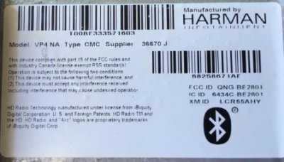

Hey guys,
Since my truck is a 2013 but the 8.4 VP4 NA is from a 2016 (I think) can I still do over the air update? I can't do the USB since my USB in the jump seat no longer works. I know I have the 911 stub antenna and I see "3G" on the radio so maybe OTA? If it is possible did I hear correct that after the update my USB port would work again? Looks like there might be a bit more iphone options that will work also. Any information is appreciated :) Thanks!
Jon aka 69mach1 (just finishing up a Mopar backup camera install also)
Now in Fernley,
8_4AN Levi label.JPG Nevada :)

Hey guys,
Now in Fernley,
View attachment 122539 Nevada :)
The USB in your jumpseat should still work as long as it's connected. I have heard of some people having issues with the media ports showing on the radio with the conversion. Is the USB option not showing on your screen? Your radio should show USB,AUX and Bluetooth. Also in many cases even if the USB doesn't show on your radio if you put the USB stick with the new firmware on it the radio will pick it up and in some cases you can install it that way. You're going to want to make sure you know exactly what year your radio is before you update the firmware because they're all different for the year. You will not be able to do any OTA updates because you are not in the Uconnect system.

Nuts. Not exactly sure just yet whether it's a 2015 or 2016 radio, when I signed up for SiriusXM Radio they said it was a Jeep Cherokee or something like that. I thought the Radio was a 2016 but when I look at my SiriusXM account it now says 2015 Ram. Any definitive way I can find out with the Head unit model & serial number? Since it was a later model radio the USB port didn't work as it only has the blue tooth Icon, no USB or Aux Icons :-( Maybe a mini USB stick (is there such a thing?) could plug directly in the back of the radio? Or maybe I have to get a OBD Genie to enable the USB port and then download the update.
