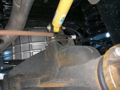

My ram 2500 2014 6.4 has an extra shock mounted from the center of the rear axle to a crossmember. when I was measuring trucks at the dealership (pre flatbed planning) I noticed that is only on gas powered trucks (5.7 and 6.4) not on diesel (6.7)
What does it do (yellow shock in center of frame)

Looks like a "Kicker Shock", which is designed to prevent "axle wrap" or rotating of the rear differential forward or back when under a heavy load..
These typically are used on the leaf spring packs themselves, but in a coil sprung rear end, they must just put it in the center of the housing.
It slows or eliminates flex, preventing the rear driveshaft from damage when the assembly, under extreme or sudden loading and unloading (wheel hop) tries to push over into a "nose down" angle that exceeds the limits of the U joints, especially when fully extended at full droop. It aids in keeping the driveshaft angle within an acceptable range throughout the full length of suspension travel (bottomed out to fully unloaded) especially in an application where there is a large amount of suspension travel available.
I have never seen this on a Coil Spring rear suspension, especially from the factory, but it is a nice touch.

I would venture that the diesels are not known for high speed wheel spin, which is what that looks like it is for. Axle wrap happens when the back wheels break loose and twist the axle forward. This then ends up with wheel hop and damages stuff. The diesels don't generally produce high rpm, that cause this effect, V8's do. Could be way off but racing experience says this is why. Same thing pinion snubbers do.

If it really is an anti-torque thing like brakelate suggested, I would think that newblackdak would have one as 4.10 truck would have a greater tendency for axle wrap than a 3.73 axle.
My truck is a outdoorsman 4x4 3.73 anti-spin 275/70r18 crew/short 6.4 no trailer prep.

I know I saw it on a 6.4 tradesman 275/70r18 4x4 crew/short with trailer prep, and not on a 6.7 tradesman 275/70r18 4x4 crew short no trailer prep

Ruins my theory. I was thinking the Megacab and CCLB maybe had a 2-piece driveshaft(or something) that prevented the problem.
