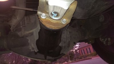

I got up under mine awhile ago to see if I had the shock and it didn't but found a oil leak coming from front of rear end hmm?
