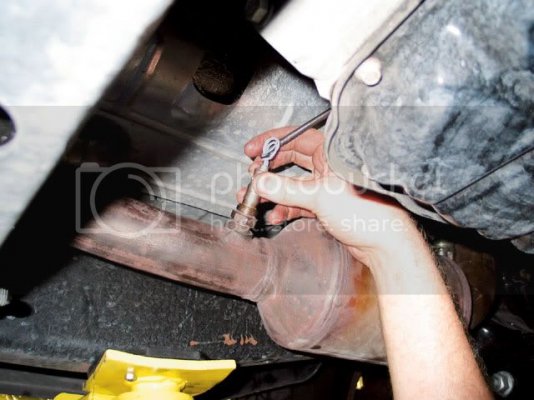

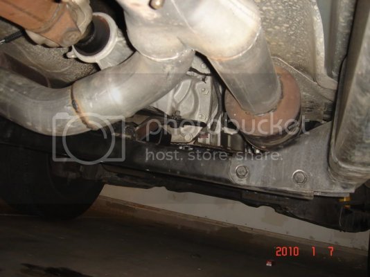

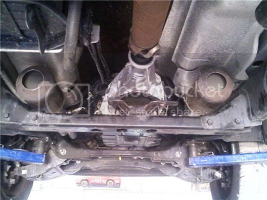

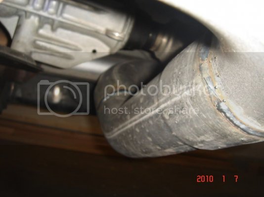

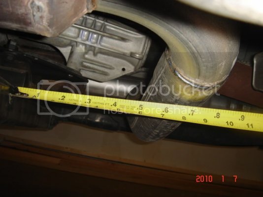

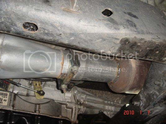

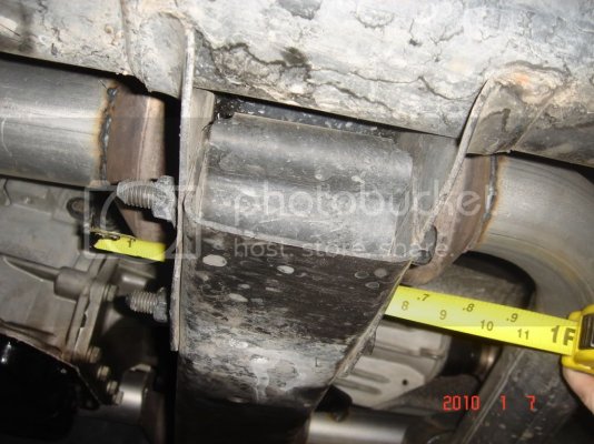

Lets start by taking a look at the stock system from the cats back
As you can see in these two pics (not off my truck) the catalytic converters are welded on, not bolted. They are bolted further up the system to the stock logs. If you were to install shorties that is where they would bolt up to, no moving of anything just plug and play. Those who want to keep the cats with Longtube headers though should note that if you simply cut the cat and keep the existing piping from the cats back you would be pushing that piping pretty far back, close to if not into the transmission pan.

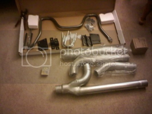

I have a set of Pacesetter LT's
I picked up a Pacesetter ORY (Off-Road-Y) Pipe, it's made entirely out of 3in piping, so no reductions.
(ignor the swaybar kit in the box)

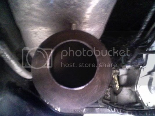

Next cut the cats off the stock piping taking note of direction and side. Take the piece of piping you cut and put it on the end of the cats and trace out a circle. Cut the cat on the trace mark or slightly under, this will give you a 3in opening on both sides of the cats.
