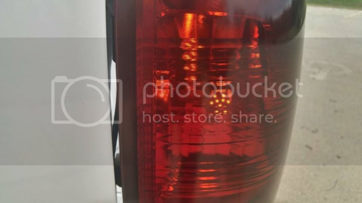

Brake lights and blinker bulbs 3157: They make orange ones. I like the clear ones though:
4X 3157/3156 Xenon 6000K White SMD Chip LED Reverse Backup Lights bulbs Lamps | eBay

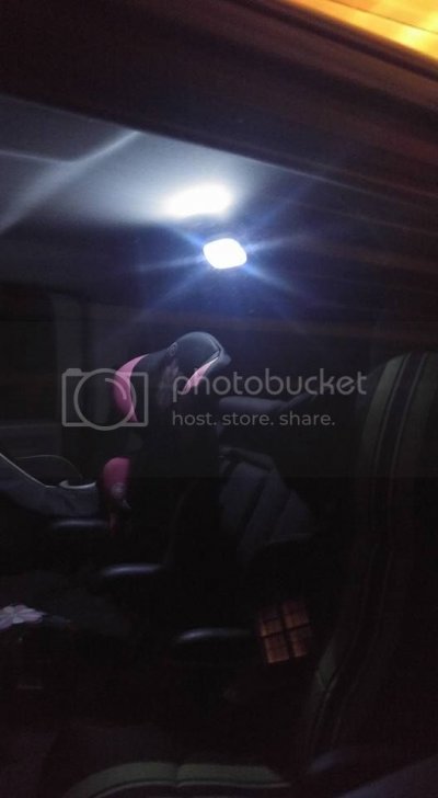

I bought this and it took care of the interior and reverse lights, the third brake light, and the license plate bulbs. I highly recommend this kit and cutting out 921link. You can knock it all out with that one kit.
12x White Interior LED Lights Package Kit for 2009-2014 Dodge RAM 1500 + TOOL

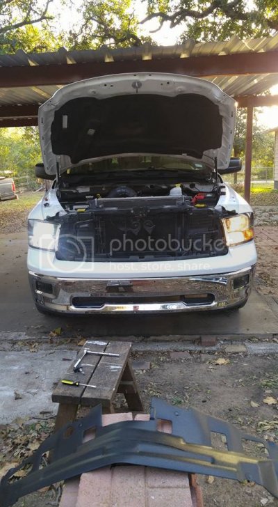

Headlight Removal I found it easier to take the grill out too:
https://www.youtube.com/watch?v=CgrUH1qs_s0

Interior Bulb removal:
https://www.youtube.com/watch?v=TmALp8DNYAo

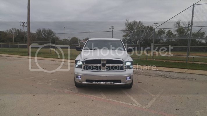

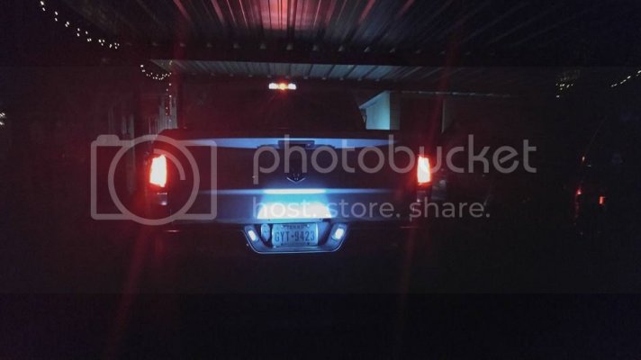

Here are some before and after pictures of my truck with LED bulbs:

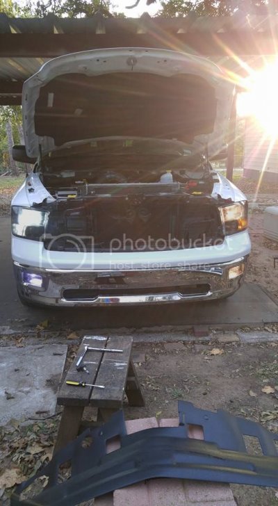

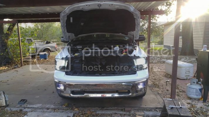

Headlight and foglight LED vs Halogen:
Brights, LED vs Halogen:

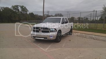

Finished excuse the cool blue fog lights, I ordered the wrong ones. I have more on the way:

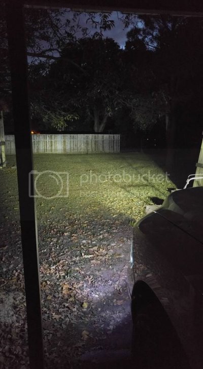

Night time shots: The fence is a good 50 yards away:
Excuse the bad shot they are aimed correctly:
Rear Shot:

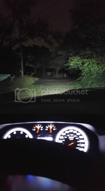

Driving shot of my super dark private drive:
