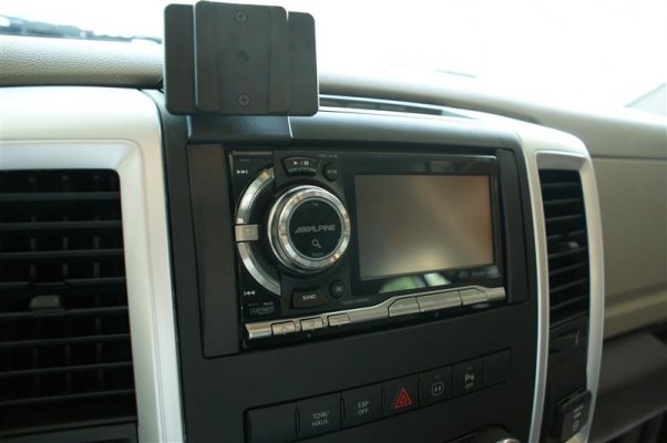

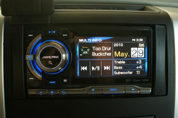

Be warned, DDs don't fit like you would think! :killer:
Looks can be deceiving. That spiffy head unit you got in your new 4th gen may look like a DD, but its not quite as tall as most aftermarket DDs. So, some light cutting is involved.

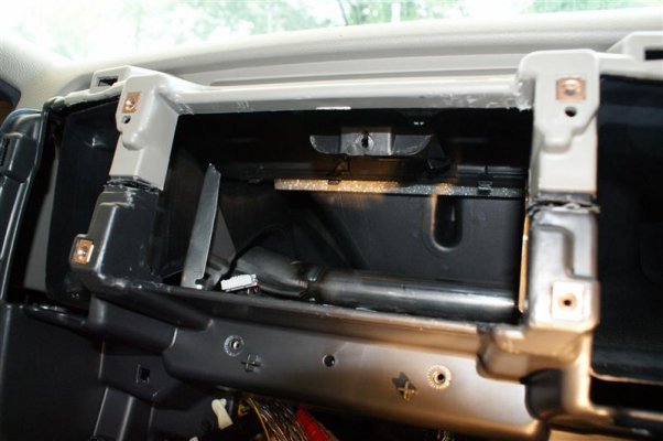

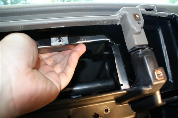

Here is what needs to be cut to fit a 4" tall DD into the stock location:
First you have to cut the plastic between the radio bolts, then you have to remove the top of the metal surround behind the radio. Tin snips to the rescue!
Pics of that:

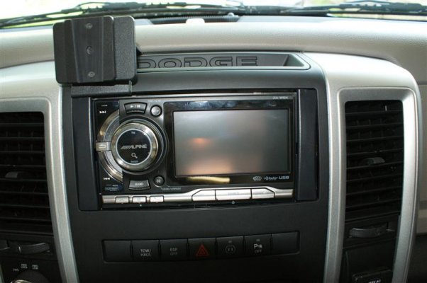

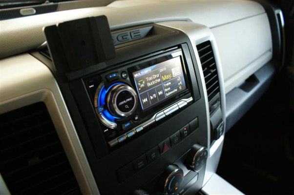

And pics of the new head unit in the truck:

that is the one down fall of the rams i think. you have to cut and mod for a dd to go into my ram as well. how do you like the ixa-404 jeremy? i have the ida-x200 and love it but it is time yo upgrade. does it have video capabilities?

nice work btw. looks stock

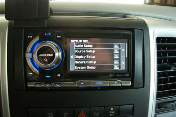

I LOVE this thing. I had a ixa-id100 (or something like that) in my 08. Loved it and knew that I am an Alpine fanboy now. :D This one does have video capabilities. I need to get back into the wiring though - I have my bypass deal sitting in the garage. Stupid what you have to do to just get into the menus on this thing. Its a parking break dance from hell.
Best part - I nabbed the head unit for like 265 on ebay. Worst part? Woot had it like a week later for 200. ********. :D
I also hate the mounting kit. Looks like ass..........I need to figure something else out there.
