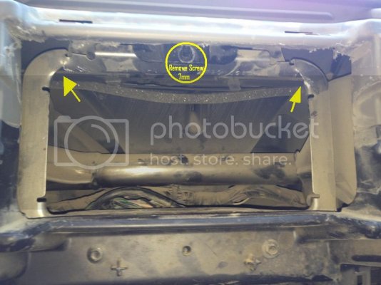

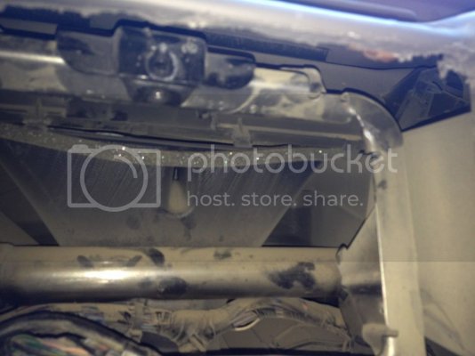

Funny part......they didn't know that you have to cut the stuff behind the dash to get it to fit! I sent them the pictures I took above, and then about a week later I noticed on their site that the DD listings changed to say a "slight" modification needed to be made to fit the DDs.

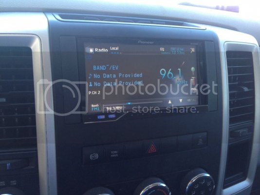

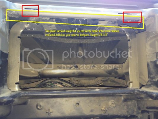

I realize this is an old thread, but I didn't have to cut it quite that much to make it fit. It'll be a snug fit, but here's the modifications I did. All I used was a pocket knife, a Dremel w/cut-off disc and a grinding stone on said dremel.
First:
Second:
Third: Take something like pliers, a crescent, or a combo wrench and slowly bend/twist the top part of the frame towards the engine bay until you get your required clearance. It should still be a snug fit so that it adds extra support to your deck.(shows blending done with grinding stone to take edges and blend the lines together)
Finish!
