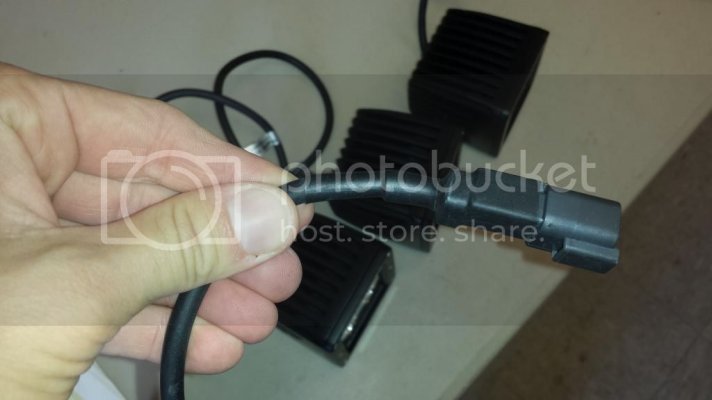

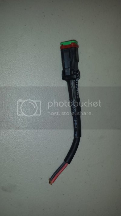

The connection point seemed of high quality and proper heat shrink used.

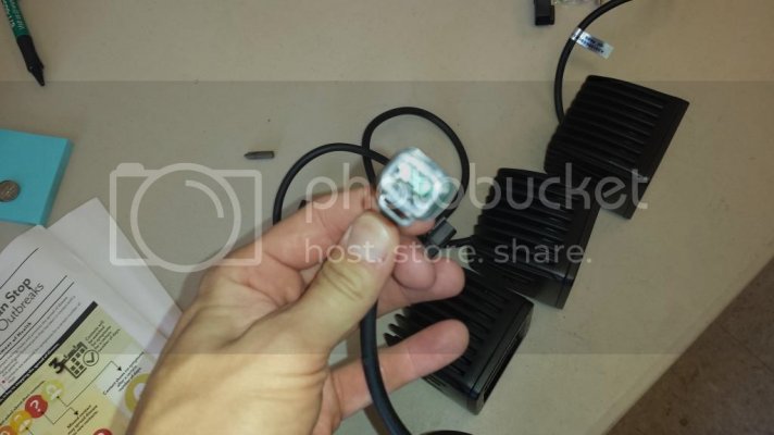

The connection from the light -
Here's the plug that plugs into the light and the other end you wire up to however you plan on powering the light. In my case and probably yours - I ordered 9006 male plugs off Ebay to wire on the end.

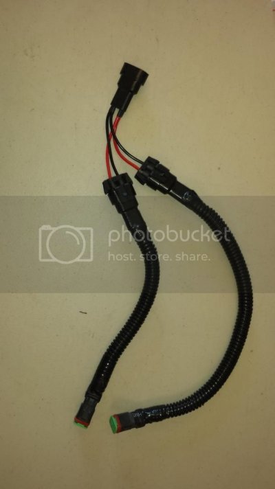

To be able to run from the stock wiring on the truck to power two lights, you need a 9005/9006 splitter. Also off Ebay. Here's what it looks like wired up-

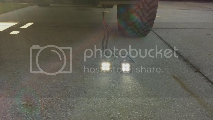

And here's a teaser shot of the lights in action -

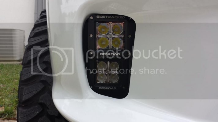

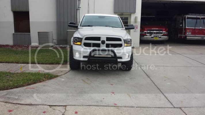

As promised - Brackets fit perfectly. Hardest part was just adjusting the lights so they were straight and even on both sides (my OCD would drive me nuts if they were not the same angle or spacing on both sides lol). I'll get some night time shots tonight. The top pod looks yellow from the flash of the camera. There's no yellow in them.
Here's the bracket mounted up -
The lights off -
Shot of both on -
Camera was pretty much straight on with this shot -

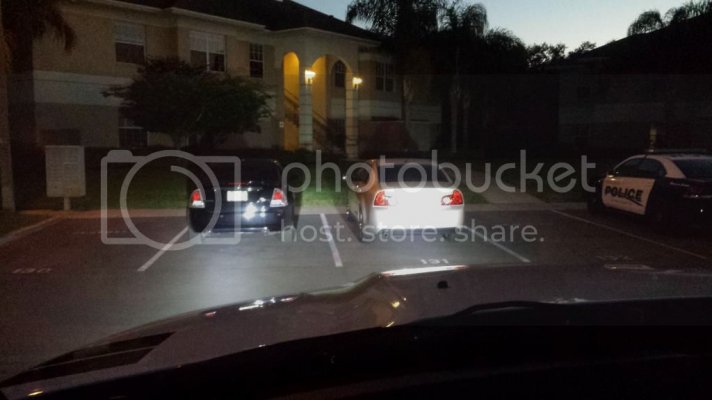

Love it, get some nighttime shots for output. Stock housings with HIDS don't do much. Thought about swapping in a projector but these fit the stylend better.
Output is pretty good. I need to adjust them to make the patterns a little better. Here is a crappy cell phone shot of just the fogs on.
